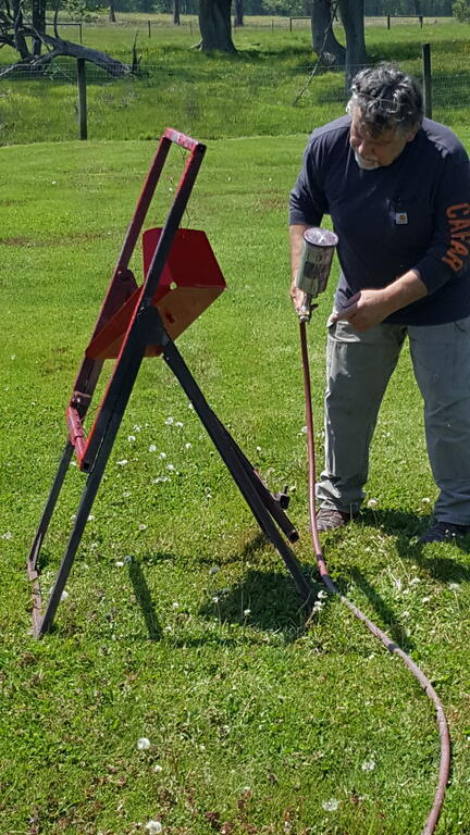

BenHolcomb 332 #101 Posted May 13, 2020 Appreciate the encouragement we're in the home stretch now. Hopefully picking up the remainder of the painted parts tomorrow. Still to do is install the starter generator, pans, guards, hood, pulleys, belts, torque the head and fire her up! Oh and stickers. Can't forget them. Side note: I plan to continue running this on AV gas. I can't get non-ethanol around me but 100LL is easily acquired and the price isn't bad. With that in mind I bought several feet of superflex aviation 1/4 fuel line. Little mod to keep it from breaking down the rubber as this stuff is safe for most everything. Share this post Link to post Share on other sites

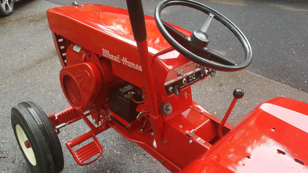

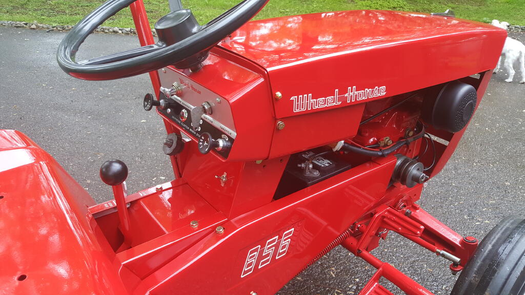

BenHolcomb 332 #106 Posted May 15, 2020 How about a few pictures from yesterday's progress? She's a runner! With a noticeable seat of the pants difference in power after the rebuild. In fact her maiden first few feet was a second gear wheelie! I slipped on the bare seat pan dumping the clutch. 2 8 3 Share this post Link to post Share on other sites
WHX?? 58,347 #108 Posted May 15, 2020 That is just beuuuutiiiiful Ben! Once you get a seat on her make sure that fender pan is latched. Those little can make that pan flip up! 4 Share this post Link to post Share on other sites

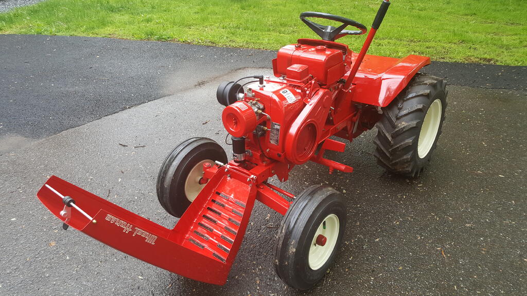

BenHolcomb 332 #118 Posted May 15, 2020 The final piece will be ready for pick up tomorrow. Everyone wants a ride! 2 6 1 4 Share this post Link to post Share on other sites

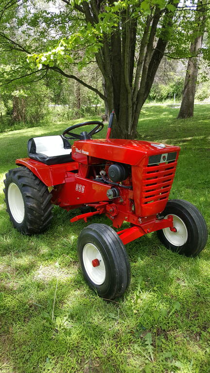

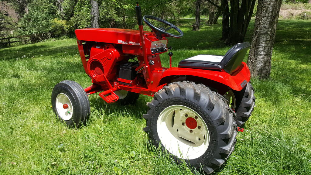

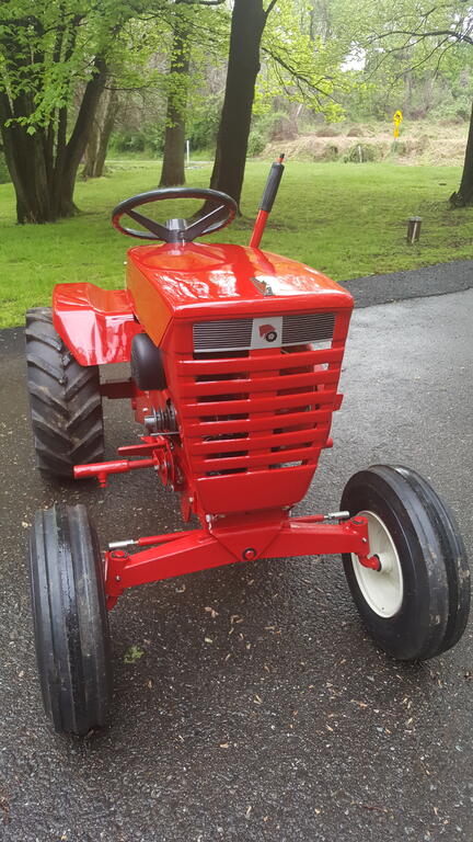

BenHolcomb 332 #120 Posted May 17, 2020 Finished. It'll never be this clean again! 2 11 1 Share this post Link to post Share on other sites
