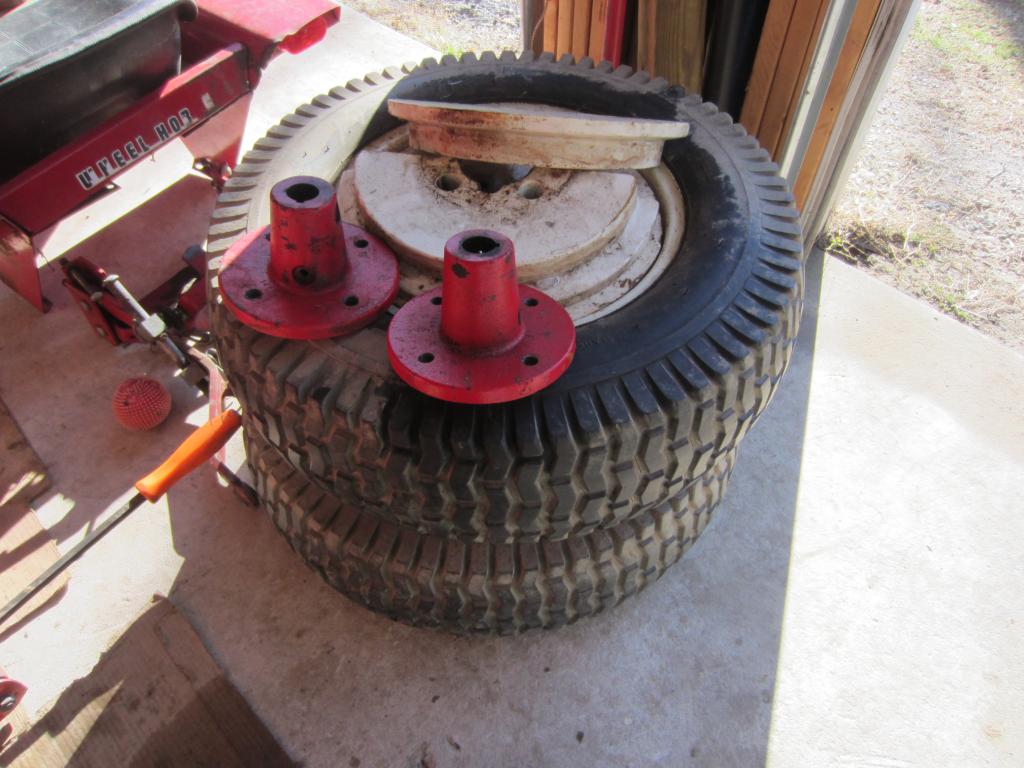

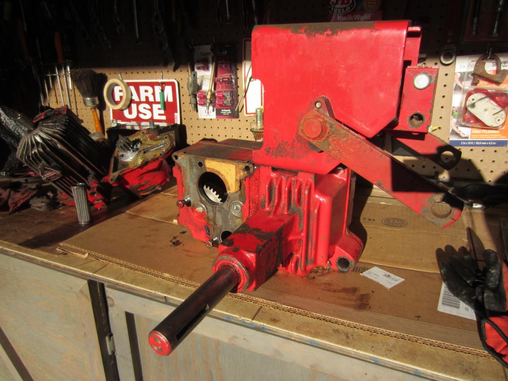

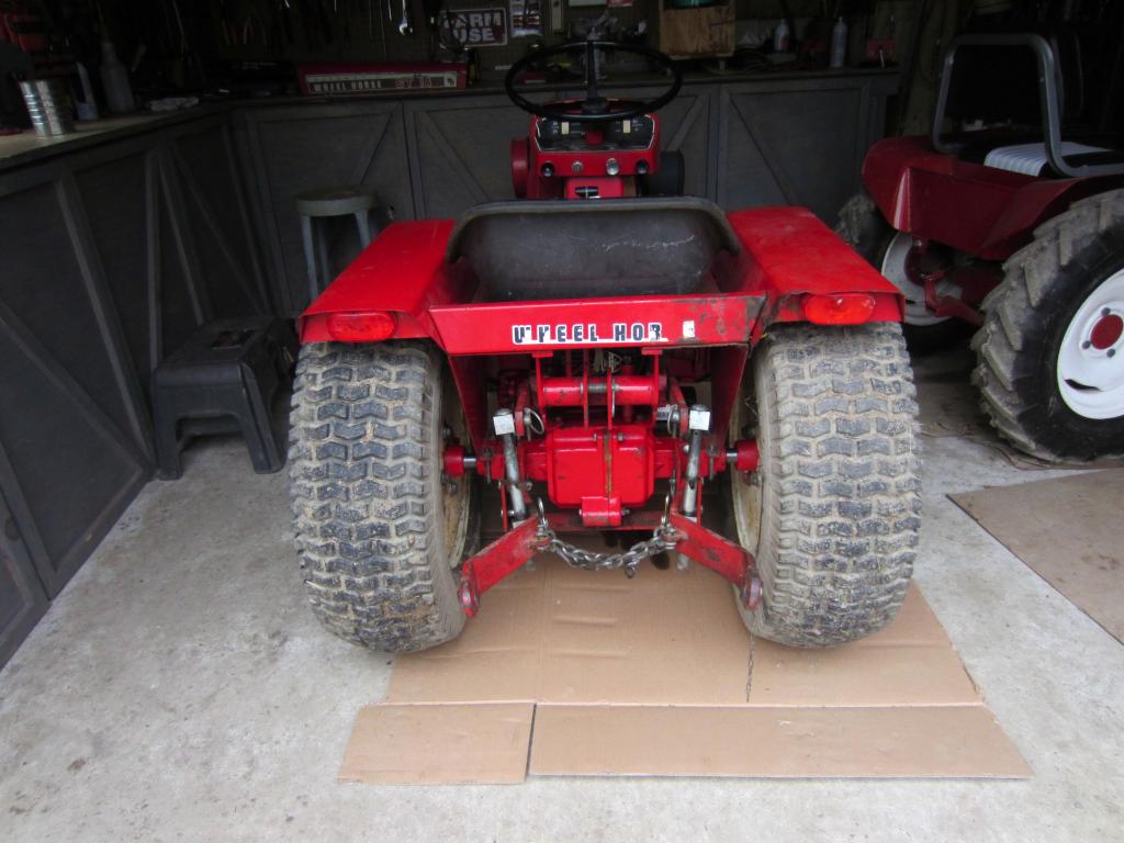

Herder 2,356 #26 Posted January 12, 2020 (edited) I've been stuck working on a friends JD for the last week or so, man what a pain in the @$$ and the hole time I was thinking of all other things that I would rather be doing. Well I have to wait for some parts to come in, so outside she went. Here's todays progress. As expected the hubs were a bit of a challenge. That dolly sure is handy. Edited January 12, 2020 by Herder 3 Share this post Link to post Share on other sites
pfrederi 20,834 #27 Posted January 12, 2020 How did you pull your hubs. One of mine is being a real PIA Share this post Link to post Share on other sites
Herder 2,356 #28 Posted January 12, 2020 (edited) 11 hours ago, pfrederi said: How did you pull your hubs. One of mine is being a real PIA I bolted the two hubs together and used threaded rod a washer and a nut. I used one hub to pull theses off. It will works most of the time. I had been spraying the keyways with BP Blaster for a while. The right side hub was tight!! I tightened up on it as much as I could and smacked it with the BFH and it popped. I will chalk it up to luck this time. I was sure that it was going to brake. Edited January 13, 2020 by Herder Share this post Link to post Share on other sites
pfrederi 20,834 #29 Posted January 13, 2020 50 minutes ago, Herder said: I bolted the two hubs together and used threaded rod a washer and a nut. I used one hub to pull these off. It will works most of the time. I had been spraying the keyways with BP Blaster for a while. The right side hub was tight!! I tightened up on it as much as I could and smacked it with the BFH and it popped. I will chalk it up to luck this time. I was sure that it was going to brake. Good for you ...mine still hasn't given way. Tried eh second hub no go ...now working pulling from behind still nothing. 1 Share this post Link to post Share on other sites

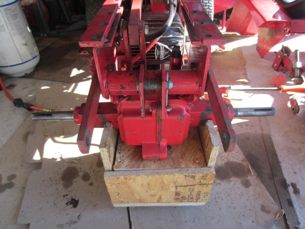

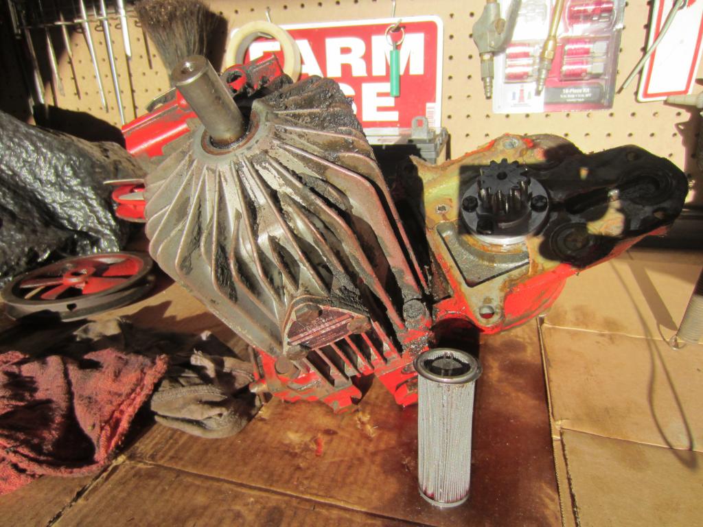

Herder 2,356 #37 Posted February 25, 2020 Here's the update, I finished up the reassembly of the pump and reattached it to the transaxle after going through and resurfacing everything. I change the acceleration springs and checked all the others, everything was good. This past weekend was the opportunity to get it in and go for a test run. Excellent!! works prefect. Thanks everyone for the assistance and this great website we have. 3 2 Share this post Link to post Share on other sites
