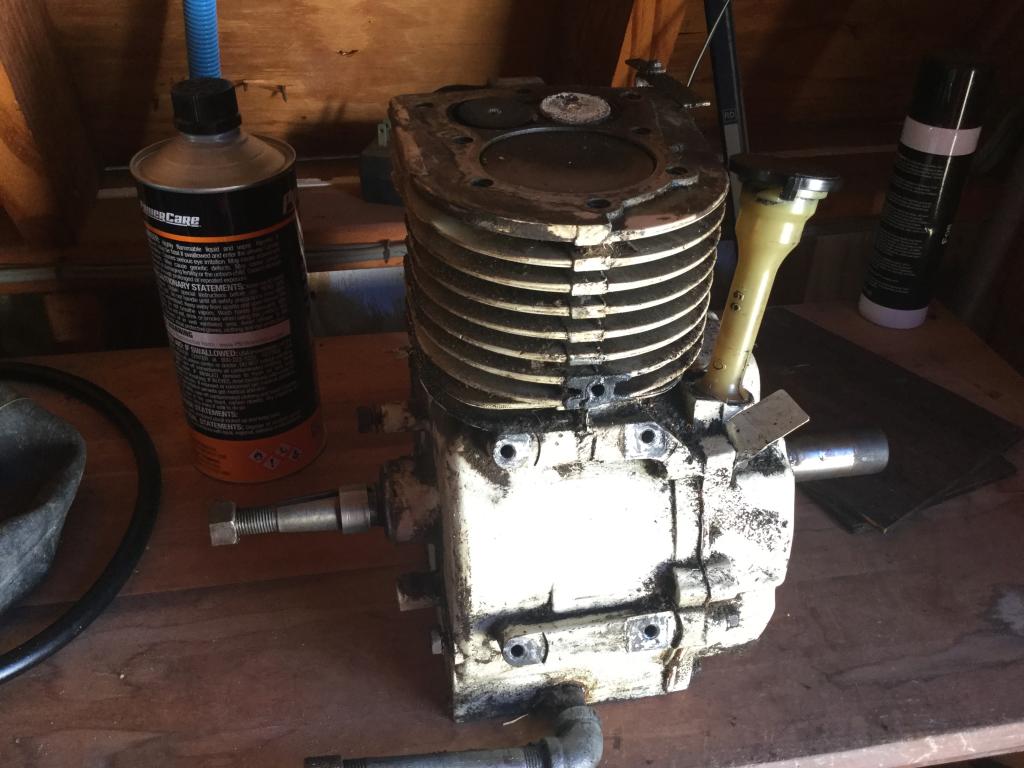

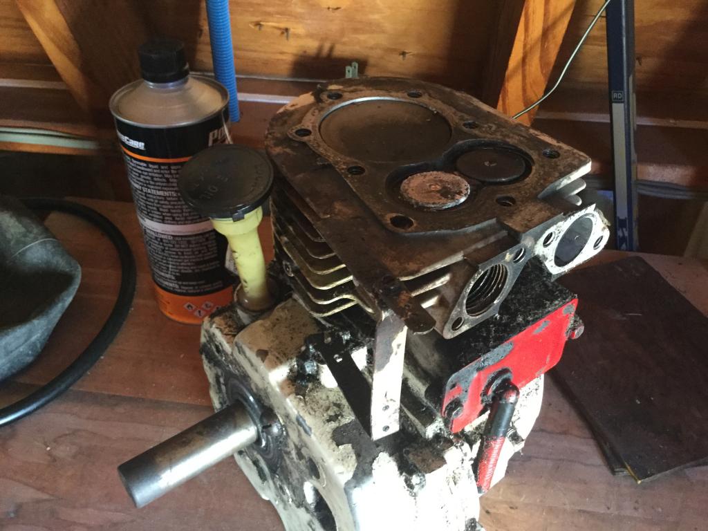

richmondred01 2,333 #7 Posted December 25, 2019 (edited) I’ve got a complete h60 block with valves, rod, piston and good cylinder. PM me if interested Edited December 25, 2019 by richmondred01 Share this post Link to post Share on other sites
