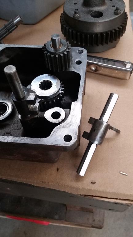

WHX?? 57,343 #36 Posted April 29, 2020 (edited) 1 hour ago, Stepney said: That said, what is this issue with the shifting rails? I saw it mentioned, but have never heard of the issue before. In early 60's trannies the shift rails were completely round. It was believed that once in gear shifting out of gear might be difficult or the possibility of grabbing two gears at once. because of the suction effect in the rail hole. When they started recommending 80/90 instead of 40 is when the problem cropped up. 63/64 and anything later they started putting flats on the rails for a return path out of the back side of the rail. This is a '62 three speed set I put the flats on. Edited April 29, 2020 by WHX24 1 1 Share this post Link to post Share on other sites
pfrederi 20,837 #37 Posted April 29, 2020 I have never been in the tranny of my L107 neither have I ever had a problem requiring prying the shift forks back into alignment...and i kinda doubt my father had any issue over the first 25 or so years. And this horse has been used a lot. Wonder why they didn't stick with 40 w. Share this post Link to post Share on other sites
