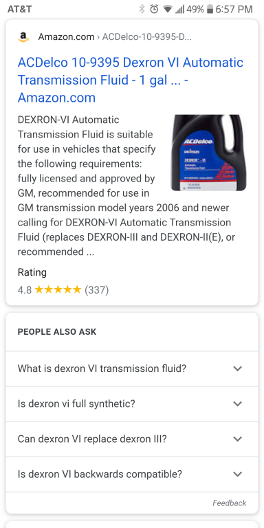

WVHillbilly520H 10,378 #5 Posted December 18, 2019 1 hour ago, WHX24 said: I guess I'm not familiar with dexron 6?? Is that like a ATF? If so it may be too thin. Dexron VI is GMs latest ATF... That's still sorta old... 1 Share this post Link to post Share on other sites
