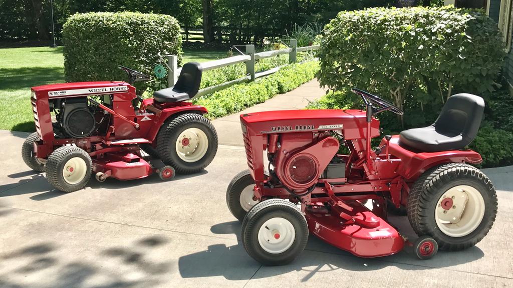

Al C. 1,429 #1 Posted December 17, 2019 On my SK-486 8-speed, half the time when I shift gears I need to release the clutch about a 1/4 inch in order to get the shifter to smoothly engage the gears. It’s always been this way. Transmission oil is 90W fresh, clean, and full. Is this a nuance or the sign of a problem. I never force the shift. 1 Share this post Link to post Share on other sites

Achto 31,115 #3 Posted December 17, 2019 20 minutes ago, Al C. said: Calendar Shot !!!! 1 1 Share this post Link to post Share on other sites

857 horse 2,588 #6 Posted December 17, 2019 54 minutes ago, Achto said: Calendar Shot !!!! Love it,,,Love it Love it !!!!!!!!!!!!!!!!! and that sun looks warm too !!!!! Share this post Link to post Share on other sites
