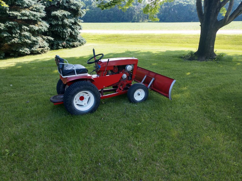

seven 202 #1 Posted December 12, 2019 I have a buddy that has a 877 wheel horse and I did some work on it last summer I put a new head gasket in a new carburetor on it. And it ran fine during the warmer weather but he says it it kills on him when he's plowing snow but then it will start right back up again and run fine? This is happened to three times? Any suggestions Share this post Link to post Share on other sites
