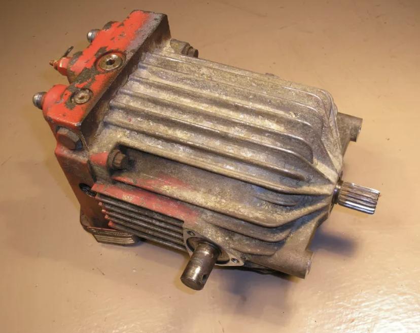

Bear G 690 #1 Posted December 11, 2019 Anyone have a good Sundstrand pump you can sell? It’s for a D-200. Pretty sure same pump is used on a few other models also. splines must be good. Mine are severely worn. The closer to north central Ohio the better. will gladly pay shipping costs if it’s too far for me to pick up. Thanks! BG Share this post Link to post Share on other sites
gwest_ca-(File Mod) 11,852 #2 Posted December 12, 2019 Have you seen the service bulletins on this failure? Garry Share this post Link to post Share on other sites
Bear G 690 #3 Posted December 12, 2019 Yes. mine has a different issue. teeth are stripped from shaft. thanks, BG Share this post Link to post Share on other sites
Sparky-(Admin) 23,990 #4 Posted December 12, 2019 I know the shaft is hardened but what if it was drilled out to say 1/4”? Could the coupling be drilled the same and then a 1/4x20 grade 8 bolt installed? 1 Share this post Link to post Share on other sites
