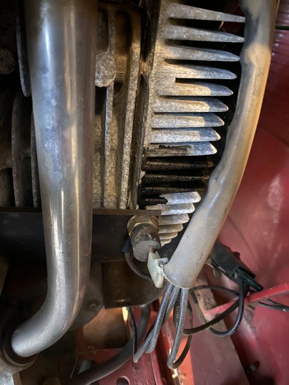

John1027 8 #1 Posted December 10, 2019 Can anyone help me out. I have a very small oil leak from one of the head bolts. It’s the only spot it leaks. It is coming from the head bolt right behind where the oil shows in the picture. Thank you in advance. Share this post Link to post Share on other sites
lynnmor 8,268 #2 Posted December 10, 2019 There shouldn't be oil supplied to that area. Clean it up with spray parts cleaner and observe to see if it indeed comes out from the head bolt. If that is what you find, then pull the head to see if there is a bad head gasket or a crack in the cylinder or some other issue. 2 1 Share this post Link to post Share on other sites
The Tuul Crib 7,340 #4 Posted December 11, 2019 I agree there should not be any leakage above this point. Does the engine smoke? 1 Share this post Link to post Share on other sites
John1027 8 #5 Posted December 14, 2019 On 12/10/2019 at 7:08 PM, The Tool Crib said: I agree there should not be any leakage above this point. Does the engine smoke? the only time I get a small amount of smoke is if I quickly bring it up to full throttle. I’ll get one small puff and that’s it. Share this post Link to post Share on other sites
ebinmaine 75,842 #6 Posted December 14, 2019 What type of machine and engine is this? Share this post Link to post Share on other sites
The Tuul Crib 7,340 #7 Posted December 14, 2019 By the looks of your pic there is a sending unit in that area.Maybe that could be the source of your leak. Share this post Link to post Share on other sites
953 nut 63,136 #8 Posted December 14, 2019 As others have said, no oil lines to the head. Clean the oil off and see if it returns first. A blown head gasket will sometimes leave an oil mark, but you would be feeling compression loss and smoke at that point. Share this post Link to post Share on other sites
lynnmor 8,268 #9 Posted December 14, 2019 2 hours ago, The Tool Crib said: By the looks of your pic there is a sending unit in that area.Maybe that could be the source of your leak. That sending unit is a temperature sensor screwed into a blind hole. Share this post Link to post Share on other sites
