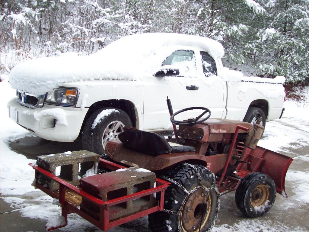

CCW 1,491 #3 Posted December 4, 2019 Made my own and mounted it. Wanted to move the trailers. 1 Share this post Link to post Share on other sites

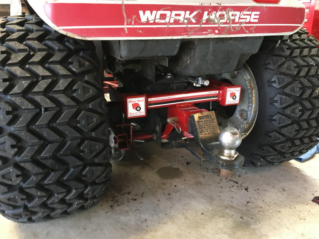

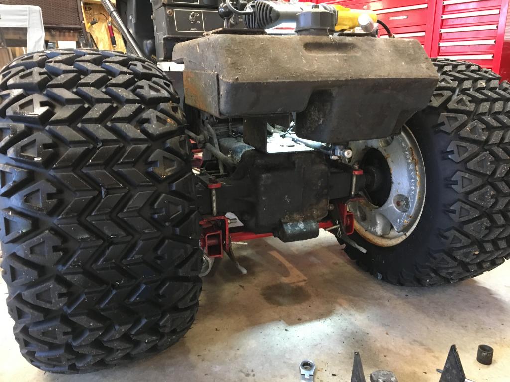

953 nut 64,330 #5 Posted December 4, 2019 I have one on the 1055 and love it. great for moving trailers and even better for adding a weight box for added traction. You can buy them from Lowell, one of our vendors. https://www.wheelhorsepartsandmore.com/hitches-liftkits.html#!/Hitches-&-Rock-Shaft-Kits/c/23548047/offset=24&sort=normal 1 Share this post Link to post Share on other sites

Sparky-(Admin) 24,668 #7 Posted December 5, 2019 Bought mine from a Red Square vendor, www.wheelhorsepartsandmore.com If your not a fabricator with a welder (I'm not) this is the way to go. All the research and development has been done by someone else for a seemless install. 3 Share this post Link to post Share on other sites
