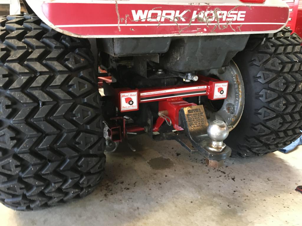

Sparky-(Admin) 23,909 #3 Posted December 2, 2019 Here’s what I use and recommend...Carlisle All Trails. 5 4 Share this post Link to post Share on other sites

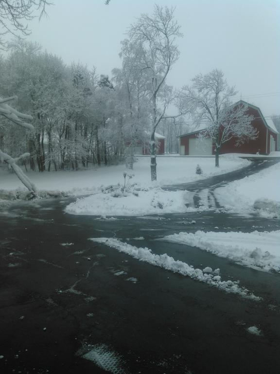

Mikey the Monkey 701 #7 Posted December 2, 2019 Just plowed our driveway. Had 6 inches of very heavy wet snow. Kenda turfs on back fulla rim guard. Turfs on front with cast iron weight. I have cast irons for the back but don't need them with this set up. Never have run any chains on blacktop and as you can see have an incline towards road. This set up works very well for me. I could definitely weight up more, but I don't need to. My vote on blacktop is good turf with added weight 1 Share this post Link to post Share on other sites

WildmanC120 613 #10 Posted December 3, 2019 23 hours ago, Sparky said: Here’s what I use and recommend...Carlisle All Trails. Are those 10" wide? 1 1 Share this post Link to post Share on other sites
Sparky-(Admin) 23,909 #11 Posted December 3, 2019 34 minutes ago, WildmanC120 said: Are those 10" wide? They’re 23 x 10.5 x 12. Mounted on wide rims. 1 Share this post Link to post Share on other sites

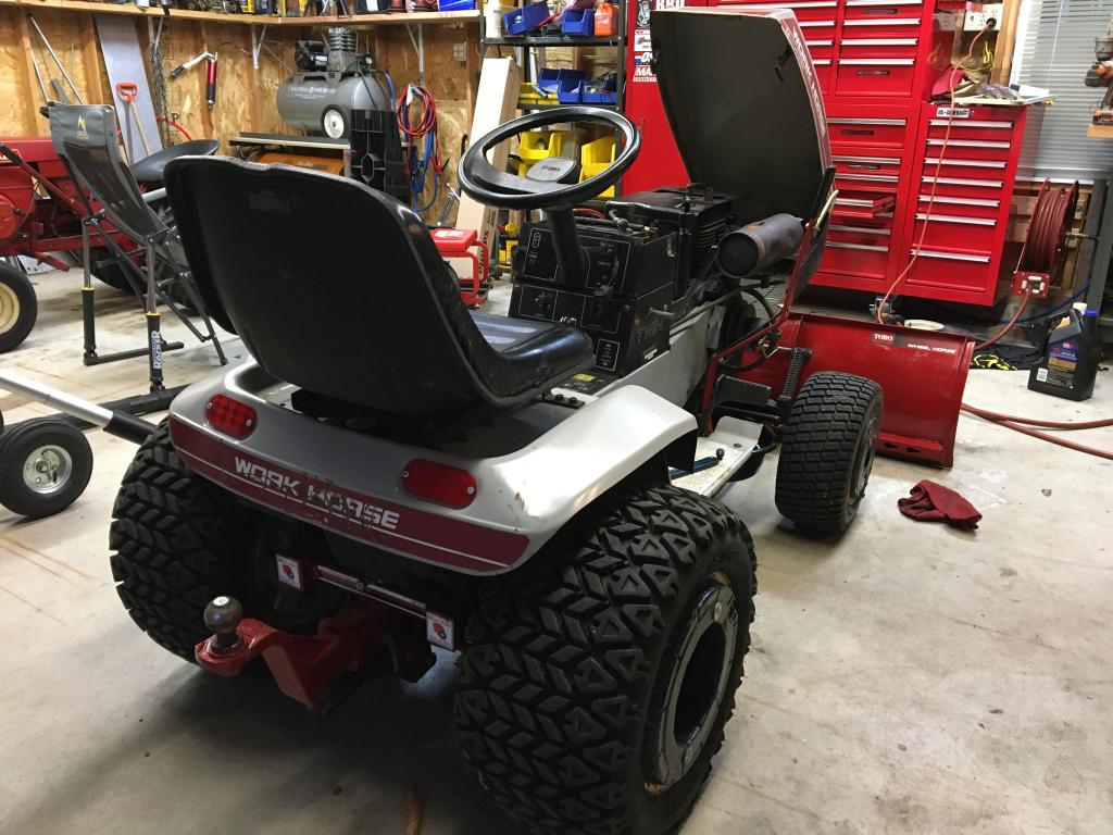

71_Bronco 1,072 #14 Posted September 16, 2020 (edited) Look at the Kenda K502 "Terra Trac" tires as well. Almost identical to the "All Trails" by Carlisle. I put them (Kendas) on my Commando 8 (all 4 corners) and am very happy with them. My rear tires are 23x10.50-12's on the stock wheels (12 x 7's I think). I think I am running 8-ish PSI in them. I plowed with this tractor this past winter with no extra weights (wheel weights or loaded tires) and only spun the tires once. I was trying to push snow from the road into my driveway (uphill slightly). The area I spun was where the road meets the driveway, and there is a little valley for water to run, so the snow was extremely wet / slushy. This year, I plan to do the same, but I picked up a pair of 55lb wheel weights for each rear wheel. Hopefully that will help (not that I had much issue this past year). EDIT: Here's a pic of the tires on the rims alone. This shows the "ballooning" that Sparky mentioned. It's not super bad, but you can see the slightly rounded nature of the tires "contact spot". Haven't tried running a lower PSI to see if that will fix it, as I haven't had any issues. Edited September 16, 2020 by 71_Bronco 1 Share this post Link to post Share on other sites
