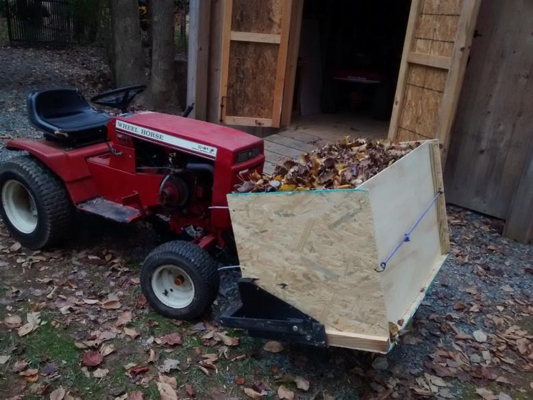

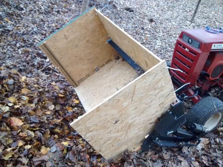

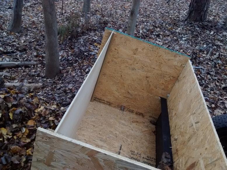

Tonyp 285 #1 Posted December 2, 2019 (edited) I built a BIG BOX and mounted it to the Johnny Bucket. 24x24x40 . 4 pieces of 1`/2 plywood, bottom, mounted to the bucket with 2x1/2 bolts/lock nuts thru existing holes , two sides mounted to the bottom., they will be mounted using 2x 3/8 bolts with lock nuts. The sides are notched so they fit directly into the rear of the bucket and the rear upper panel which uses 4 tie wraps to hold it in place I did also make a front which slides in and out. This is 1/4 ply. The whole thing takes maybe 5 min to install or remove. The value ? Oh yeah, holds easily a large tarp full of leaves , compressed, then drive off and dump it ! Leaves, debris, whatever . I actually don't mind LEAVES duty, I hate the hauling part., Whoever thinks the Johnny Bucket is too expensive needs to rethink "BACK " Of course I do have a dedicated C81 for the Johnny Bucket. even at that, the JB detaches in minutes. The uses are only limited by our imagination ! My BACK has been sending me private messages of THX daily ! Edited December 3, 2019 by Tonyp 4 1 Share this post Link to post Share on other sites
