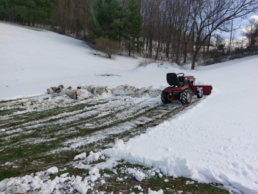

WVHillbilly520H 10,379 #27 Posted December 14, 2019 2 hours ago, Sherwood’s Power said: I have the rears weighted with iron and liquid but no front weights. The tractor pushes the stuff ok if push it to the sides but if you try to straight push forget about it(again we snow). The problem I have is I need to push it 200-300 ft to get it across the street and the 48” on the 520 just don’t have the ass to straight push wet stuff. I want to modify the 54” and make removable wings for it. I’m going to take another 54” and section it out. Not sure how wide I’ll go though Here's my 520 with 54" moving snow just a couple years ago... 2 1 Share this post Link to post Share on other sites

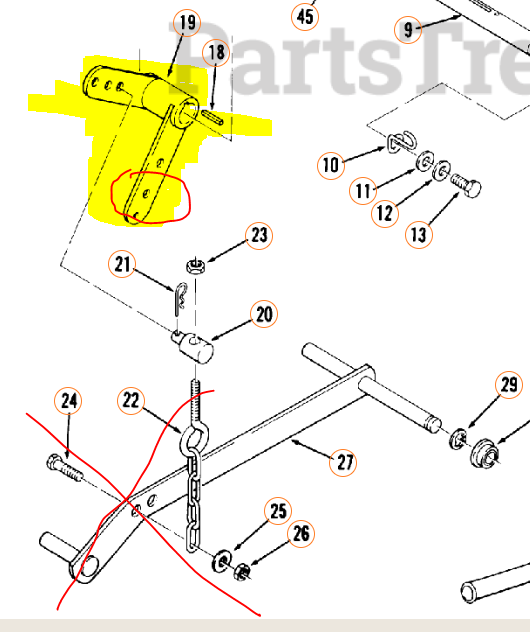

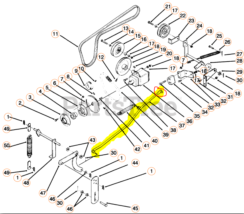

Alex175 785 #35 Posted December 20, 2019 3 hours ago, Gas Man said: I can see that it will mount just fine, but I can't figure out how I will get the lift attached to it. I've never dealt with the two stage blowers myself, though I wouldn't mind at some point. Looking up quickly the parts list on Toro 79361 I pulled up this diagram. Excuse my Windows Paint additions to the diagrams, but In my first image the highlighted yellow part is your lift bar, and should run all the way back to your lift mechanism on the C-175. Now there is an important distinction in your lift mechanism for the snowblower if you haven't use one before. Unlike a mower, or plow that use the area marked by the red X in my second image, your blower should attach to the main lift linkage up above it, as shown with the highlight and red circle. That is provided all the components are the right length, as I do not know if distances changed between the C Series and the 300 series. But provided all the lengths are the same everything looks to me like it should bolt up nice, but I am not 100% sure as I have never done this myself, I'm just going based off of pictures. Good Luck to you though, and if it works I, as well as I'm sure many others would love to see pictures of it all complete! Share this post Link to post Share on other sites
