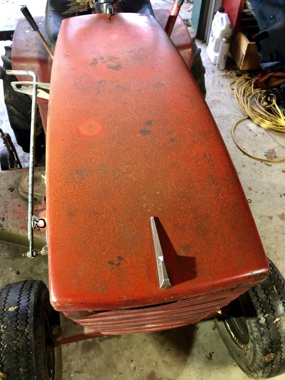

The Tuul Crib 7,340 #1 Posted November 24, 2019 have been working on Irv and like a fool I open the garage door and couldn't resist pushing this one in the shop . All complete except for it needs a motor. No repaint sand it down and leave the patina ! all the hardware and deck parts are intact hopefully the transmission is good! 10 1 Share this post Link to post Share on other sites

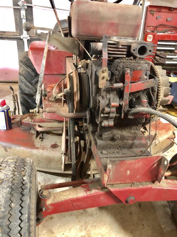

The Tuul Crib 7,340 #3 Posted November 24, 2019 OK here's the first question it's got a 10 horse Tecumseh HH 100 and I'm going to put a K301 on it. Is there much difference in crank height between the two? I'm planning on using the same pulley on the engine for the drive belt . Share this post Link to post Share on other sites
pfrederi 19,881 #4 Posted November 25, 2019 Not if you do away with the mounting plate under the techy..(I assume your 301 has the big oil pan not a shaker mount) Share this post Link to post Share on other sites
The Tuul Crib 7,340 #5 Posted November 25, 2019 11 minutes ago, pfrederi said: Not if you do away with the mounting plate under the techy..(I assume your 301 has the big oil pan not a shaker mount) Yep!! Share this post Link to post Share on other sites
ZXT 2,401 #6 Posted November 25, 2019 4 hours ago, The Tool Crib said: like a fool I open the garage door and couldn't resist pushing this one in the shop I might have done this once or twice! I'm easily distracted. As for the engine swap, I went from a HH120 to a K321 with no issues. Used the pulley and everything. Not the same tractor but the base is the same on the Tecky so it's likely the same. Only thing I had to do was modify the belt cover some. 3 1 Share this post Link to post Share on other sites
ebinmaine 77,340 #7 Posted November 25, 2019 6 hours ago, ZXT said: might have done this once or twice! I'm easily distracted Oh yeah... Me t... Hey ... shiny !!!!! 1 Share this post Link to post Share on other sites

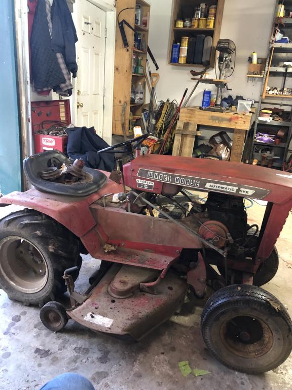

Herder 2,355 #8 Posted November 25, 2019 From this to this, Raider 10 (Techy) to Raider 16 (Kohler) I used the engine, wiring harness, voltage regulator, key switch and control cables from a C-160. I reused the drive pully from the techy in order to maintain the same size. Everything fit as it should and the Raider 16 was born. Big Blocks Rule!! 1 4 Share this post Link to post Share on other sites
