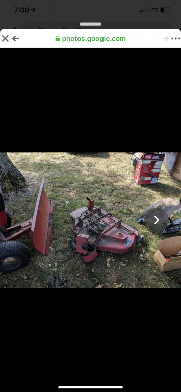

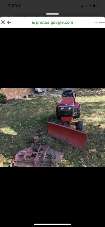

KAD88314-A 5 #13 Posted November 25, 2019 Above is the picture of the deck. The model and serial is rubbed off. It’s a 3 spindle deck so it may be larger than 36”. It is currently in storage so I cannot measure it at this time. 1 Share this post Link to post Share on other sites
peter lena 9,768 #14 Posted November 25, 2019 interesting that it looks like a 36" r/d deck yet it has a side discharge chute that would be on a 42 ' deck. more picture detailing and related info will give you an answer, it would not be the first w/h with , " modified attachments " , let us know what ever you can , when you can , pete Share this post Link to post Share on other sites
KAD88314-A 5 #15 Posted November 25, 2019 From what I can tell from the internet is that in 1983 they made a model 05-ms3602 and a 05mr3602. S for side and R for rear I’m assuming. They come with the same blade set from toro though. 3/4” shaft hole and 2, 12-1/8th Length outside blades and one 14-1/8th center blade. Which doesn’t make sense to me being a side discharge mower. Share this post Link to post Share on other sites
