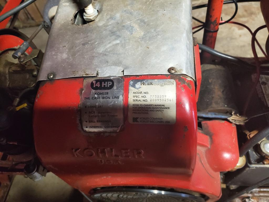

12Horse Paladin 1,038 #1 Posted November 18, 2019 After recieving more info, it has been brought to my attention that the 14 horse Kohler in my Bronco may be a replacement motor. Other than the tag, are there things to look for? How do i find the date of mfg? Ive enclosed a pic that sparked this thread; but the numbers are: SPEC # 7752259 SERIAL # 2009502561 Thanks for any info; may you all have a great day, and week😊 Share this post Link to post Share on other sites
gwest_ca-(File Mod) 11,853 #2 Posted November 18, 2019 A Kohler 10-digit serial number starting with 20 is 1990 model year production. There is a chart on the first pages of the service manuals. Click on the picture The Spec # 7752259 is actually the Kohler part number for the replacement engine https://www.partstree.com/search/?type=part&term=7752259 Garry Share this post Link to post Share on other sites
