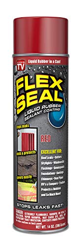

cafoose 3,635 #5 Posted November 17, 2019 Is this worth a try? it's available in red Share this post Link to post Share on other sites

pfrederi 19,955 #7 Posted November 17, 2019 1 hour ago, cafoose said: Is this worth a try? it's available in red It says you can paint it when dry...That must mean it isn't very slippery if paint will stick so can snow 1 Share this post Link to post Share on other sites
peter lena 9,781 #8 Posted November 17, 2019 cafoose, that seal flex will not have the slick finish that the snow slide has , as i just put it in place , inside the snow chute , it just easily found itself, with a very smooth curved arc inside the chute. mine is also red in color , i will get a few pictures to show effect. dr frankensnow. 1 Share this post Link to post Share on other sites
