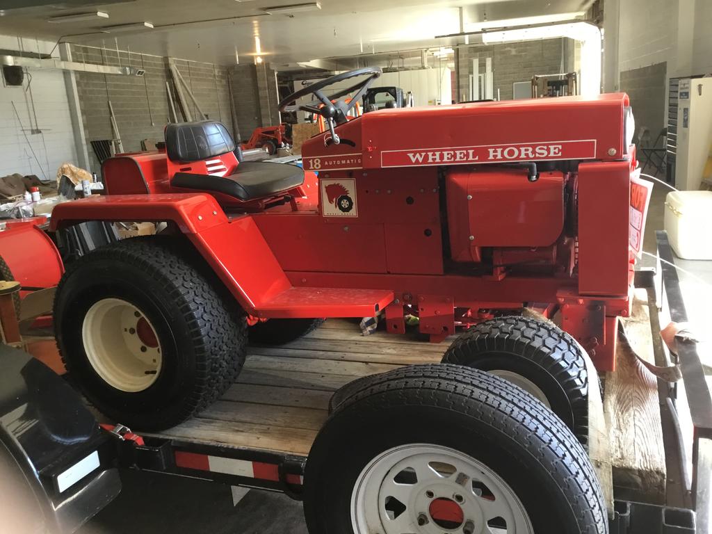

I have been trying to find more information on my Wheel Horse. I have my model number and vin number and looked on several  suggested sights and no luck. Any suggestions? Thanks In Advance

If you would share the model number and perhaps a picture we can probably help out.

Horse with No Name
The model number is 10601  8 South Bend Indiana. I have been told it is Not a no name. I sure appreciate all of you giving me your input.

D series of some sort.

Horse with No Name
Just now, Horse with No Name said:
10601  8      945902'
Sparky
12 minutes ago, Horse with No Name said:
10601  8      945902'
1-0601 1973 D Series Garden Tractor 18 HP Automatic Kohler K482S-35209B 18 Sundstrand 90-1137
  • Like 5
wallfish
 If you want to give it a name then use 1973 D180.
  • Like 2

Razorback
Wow!!! that is a beautiful, very capable GT!

gwest_ca
What a beauty and the earliest model 1-0601 that has surfaced. The 8 on the end is not used but if you subract 5 from the 6th digit you get the model year. 8-5=3=1973. Attachments at the time also had the 6th digit.
Added your serial to the list. Click on the fuzzy picture.
Here is everything we have on this model tractor in no particular order so look through them all
https://www.wheelhorseforum.com/search/?&q="1-0601"&type=downloads_file&search_and_or=or
