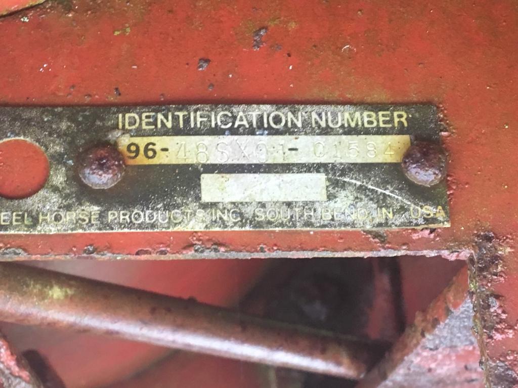

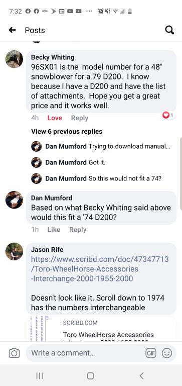

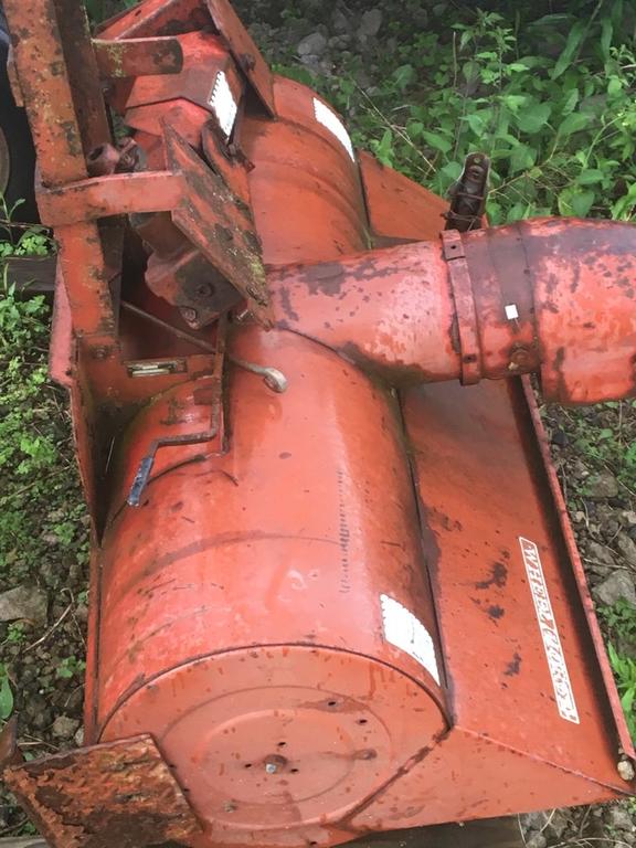

Joker72 91 #1 Posted November 15, 2019 (edited) Can any one confirm that this snow blower will or will not fit my '74 D200. Thanks in advance. Edited November 15, 2019 by Joker72 Share this post Link to post Share on other sites
Dirtdog524 61 #2 Posted November 15, 2019 quick google search says that it fits a d250 Share this post Link to post Share on other sites
gwest_ca-(File Mod) 12,015 #4 Posted November 15, 2019 D-Series Automatics use a x6-48STxx numbered like the long frame tractor snowthrowers but the only models to use a 48" snowthrower other that the D-250. 96-48SX01 definitely fits a D-250 10-Speed. Here is the model sold in 1974 for the D-Series Automatic models. Click on the picture and it will take you to a list (DNA) of all the compatible models. Garry 1 Share this post Link to post Share on other sites
