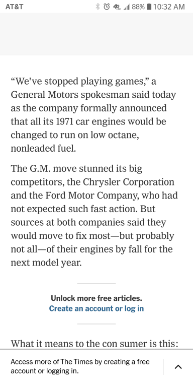

troutbum70 858 #26 Posted March 3, 2020 Mid 70's I think in my part of the country or real early 80's. All though they were experimenting with it a long time before that. Share this post Link to post Share on other sites

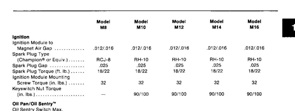

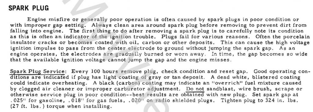

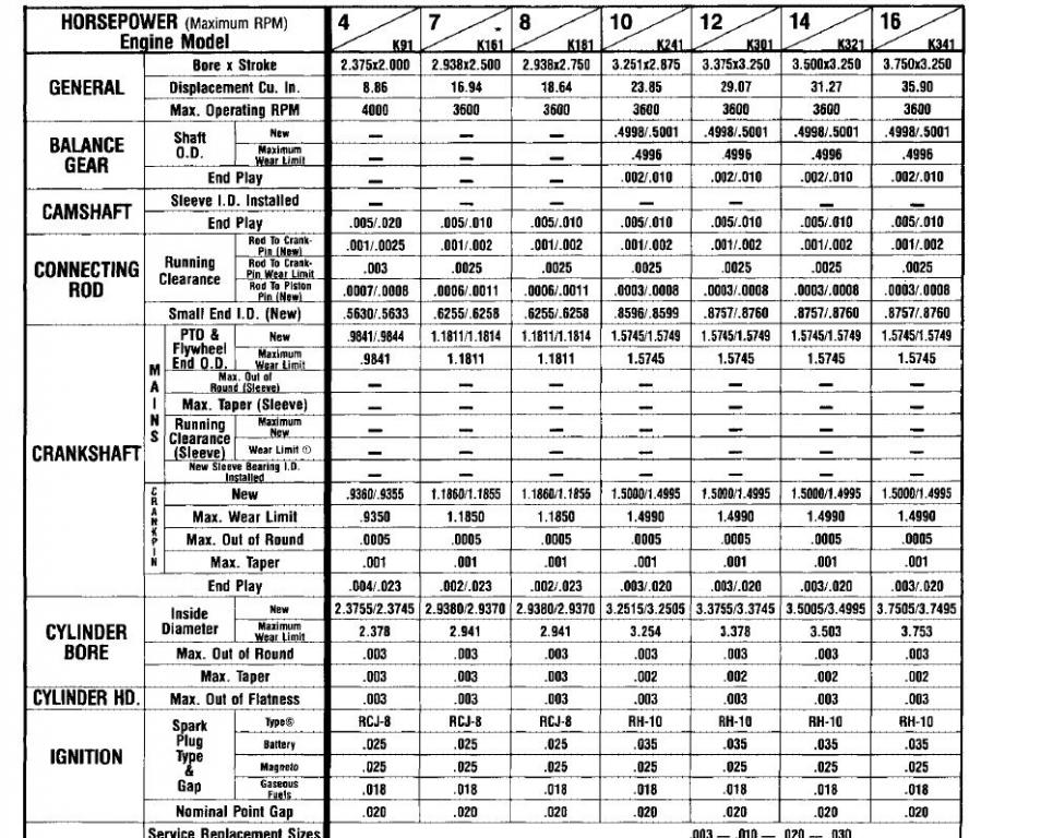

pfrederi 20,063 #28 Posted March 3, 2020 12 hours ago, CCW said: According to the Kohler service manual I download from RS the gap should be .025. Am I missing something regarding the .035? Depends on what Kohler specified during that time frame. Older K series service manual is .025 for all gasoline engines. Later K series manual bumped it to .035 for battery ignition big blocks but kept .025 for magneto and small blocks. Interesting no mention of breaker less. Spark plug torque stayed the same at 27 ft/lbs. Magnums had .025 for all singles but the spark plug torque was reduced to 18-22 ft/lbs. Since Kohler couldn't decide consistently I wouldn't lose that much sleep over plug gap and i sure would not waste my time trying to index it. These are garden tractors not Ferrari's.... 1 Share this post Link to post Share on other sites
