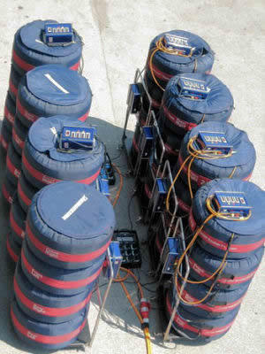

tom2p 2,394 #4 Posted November 13, 2019 I might go with the F1 tire warmers Share this post Link to post Share on other sites

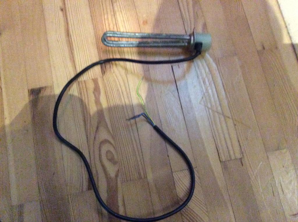

Tractorhead 9,216 #9 Posted November 13, 2019 Possible other Options Aircooled Engines - change thinner Oil i use 10W40 in nearly all Engines. Didn‘t do something for oil warmup, because no possibilities now. if i have sometimes the ability to do, i use a old Hairdryer, that faced to the Oilpan. Usin a remote to heat up the Oilpan about 10 min before Start. Watercooled Engines - i have some simple solution. A Block heater, that is coming out of an Caravan heater( boiler) and is restricted to 60 deg C ( self controlled) by a Thermo Switch. build in a Aluminum Box with a Waterpump, attached to the Heater Circle. That will do the Trick, same like a Block heater or a Webast Fuelheater. 1 Share this post Link to post Share on other sites

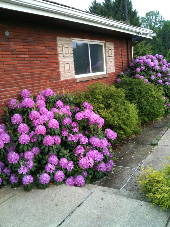

tom2p 2,394 #17 Posted November 14, 2019 (edited) 7 hours ago, peter lena said: maybe, some spray cam expanding foam to plug up those mouse tracks , then poison and trap bates , to finish them off. had a similar issue that expanding foam easily stopped , mouse hater, pete the foam would help for sure and I have used it in a few spots but I've seen mice fit under garage doors with a tight fitting bottom seal also seen them climb vertical brick walls and fit in tiny holes between the brick / mortar joint and the wood overhang pic below of our house - same area where I've seen them crawl straight up the brick and the into a tiny hole between brick and wood the mortar joints are fairly deep (except for vertical joints on courses where brick face is out) - and this provides just enough of a spot they can crawl into Edited November 14, 2019 by tom2p Share this post Link to post Share on other sites
