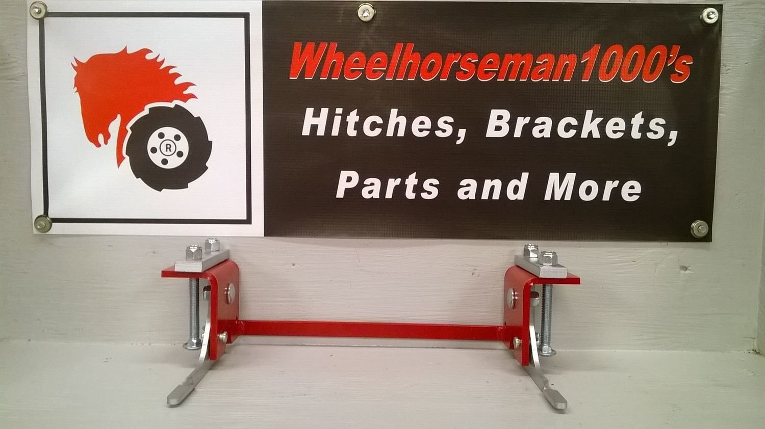

953 nut 62,316 #4 Posted November 13, 2019 If you don't already have one, the dozer blade/snow plow attaches to an axle bracket on the rear axle housing. Be sure the seller is including it in the price of the snow plow. Share this post Link to post Share on other sites
