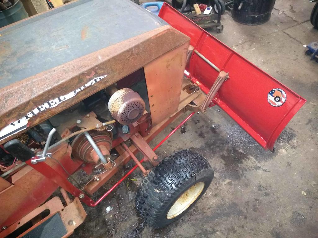

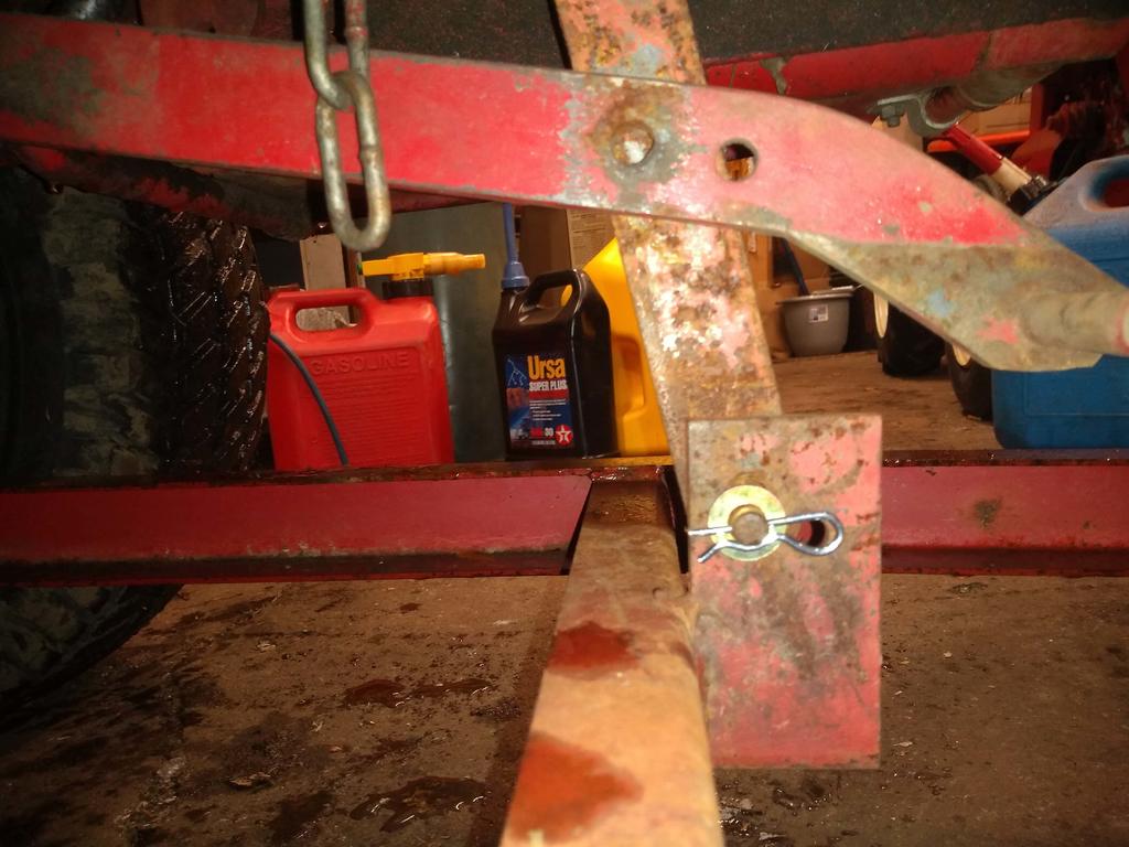

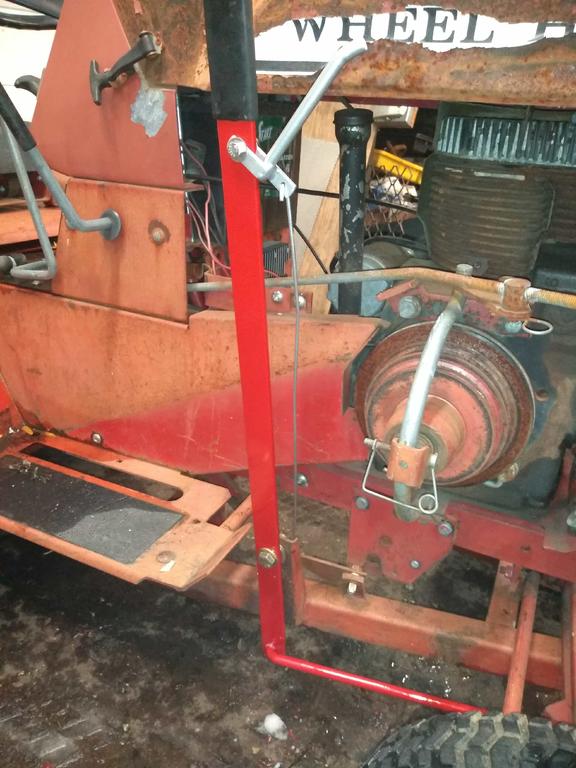

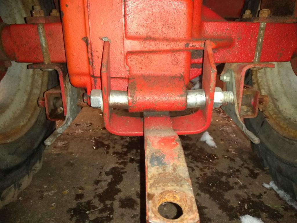

Achto   31,004 #8 Posted November 10, 2019 10 hours ago, 12Horse Paladin said: I would appreciate any further info and the pics greatly!  Here are the some pics, hope they are helpful.  Easiest way that I have found to mount a push blade plow is to start by removing the handle for the pivot control. This way you can drive the tractor right over the plow. Next attach the plow to the rear mount.  Next connect to the lift link, pay no attention to the lift bar for the mower deck I have a solid link bar on mine, this allows me to have down pressure. I if you use chain to attach to the lift the only down pressure you will have is the weight of the plow.  Install the release wire and pivot arm.  Ready to plow!!  A relativity simple installation. 1 Share this post Link to post Share on other sites
