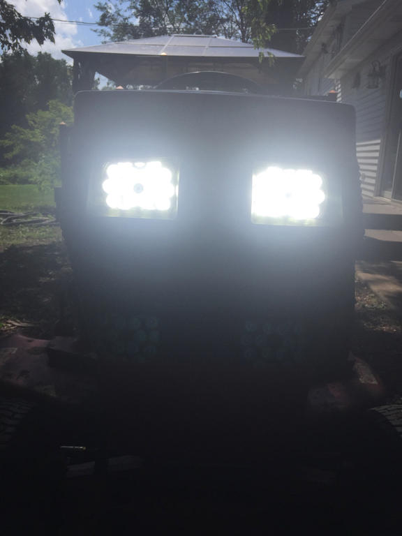

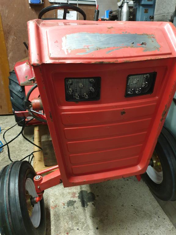

Sparky-(Admin) 23,909 #2 Posted November 8, 2019 There are a few guys who have posted up their headlight upgrades. This was mine... 1 Share this post Link to post Share on other sites

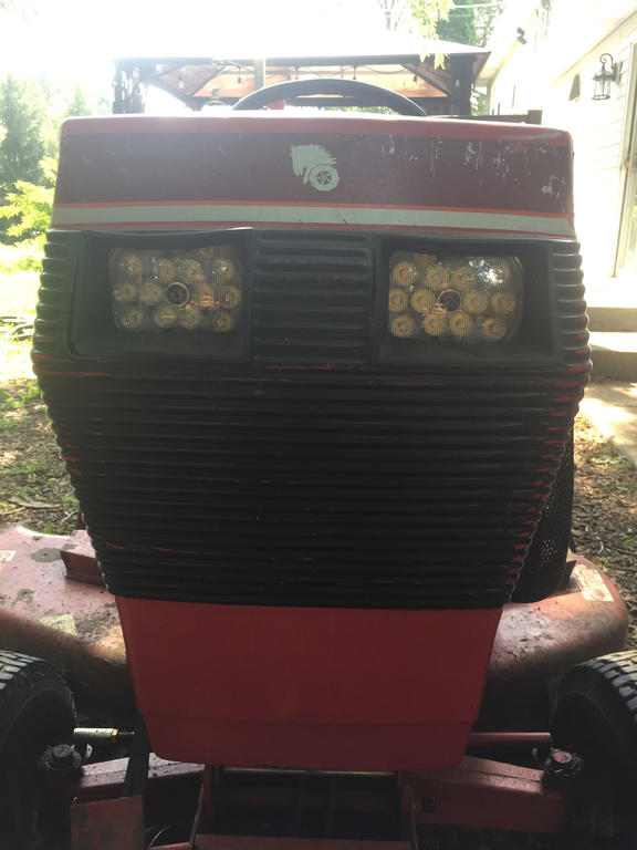

Lee1977 7,432 #4 Posted November 8, 2019 (edited) I can't say they will work in a 416. I had to take mine apart and put them back together in the hood to get them mounted, I first thought they would mount behind the bracket, but there wasn't enough room. They are 24 watt Cree flush mount. The vinyl inserts will have to be trimmed. I have a new set but my 520 need paint and I'm waiting to see if I want to use the new set on it. Edited November 8, 2019 by Lee1977 1 Share this post Link to post Share on other sites

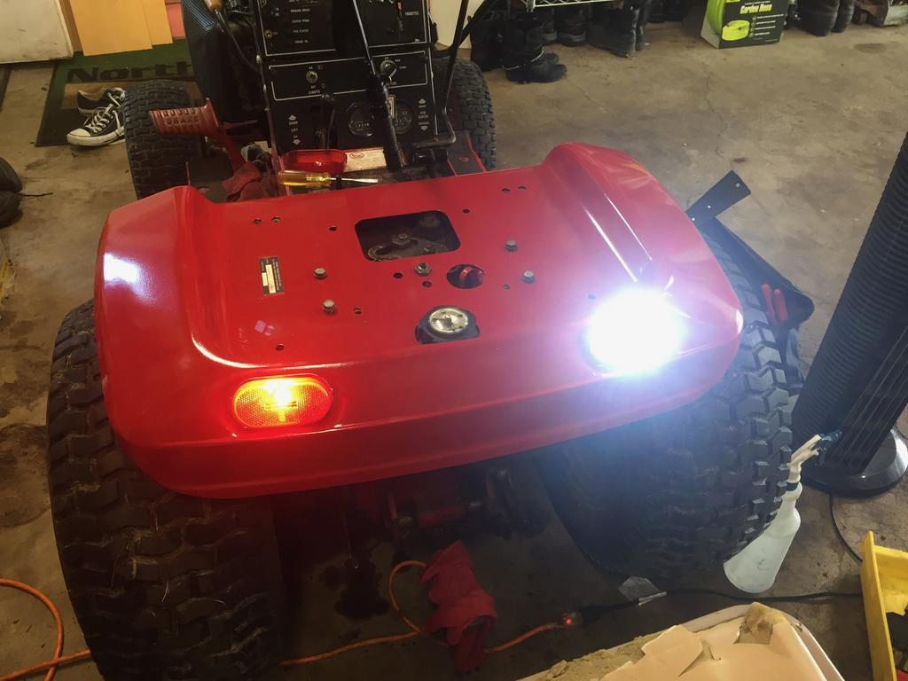

Andy N. 2,594 #7 Posted November 9, 2019 I installed these LED's on my 418-A. I have enough for my other WH's, just haven't had enough time to install. Huge difference in brightness between the original halogen and the new LED's. You will need to modify the headlight wire connections. Headlights: https://www.amazon.com/gp/product/B01NAB4RTV/ref=ppx_yo_dt_b_asin_title_o03_s00?ie=UTF8&psc=1 Taillights: https://www.amazon.com/gp/product/B01M13CB62/ref=ppx_yo_dt_b_asin_title_o03_s00?ie=UTF8&psc=1 1 Share this post Link to post Share on other sites

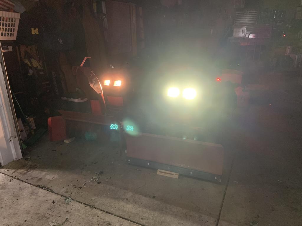

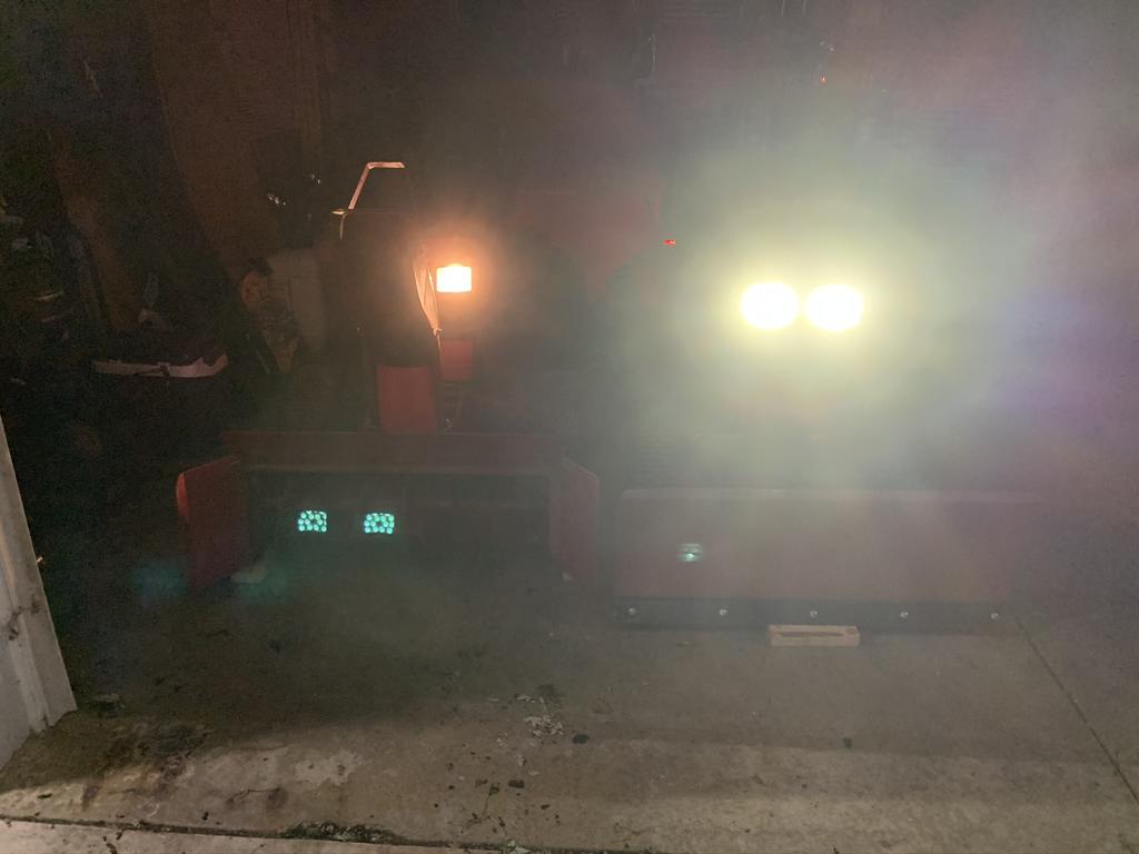

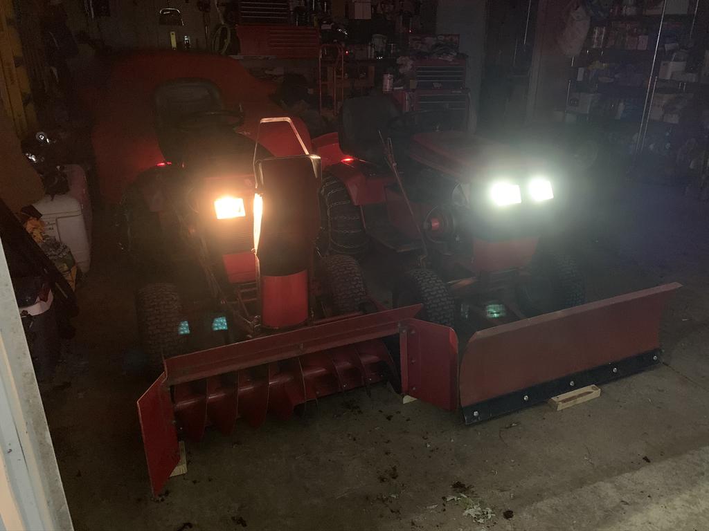

Andy N. 2,594 #9 Posted November 15, 2019 Just got my herd ready for winter. Here are some side by side pics of LED vs. Halogen. 1 1 Share this post Link to post Share on other sites
