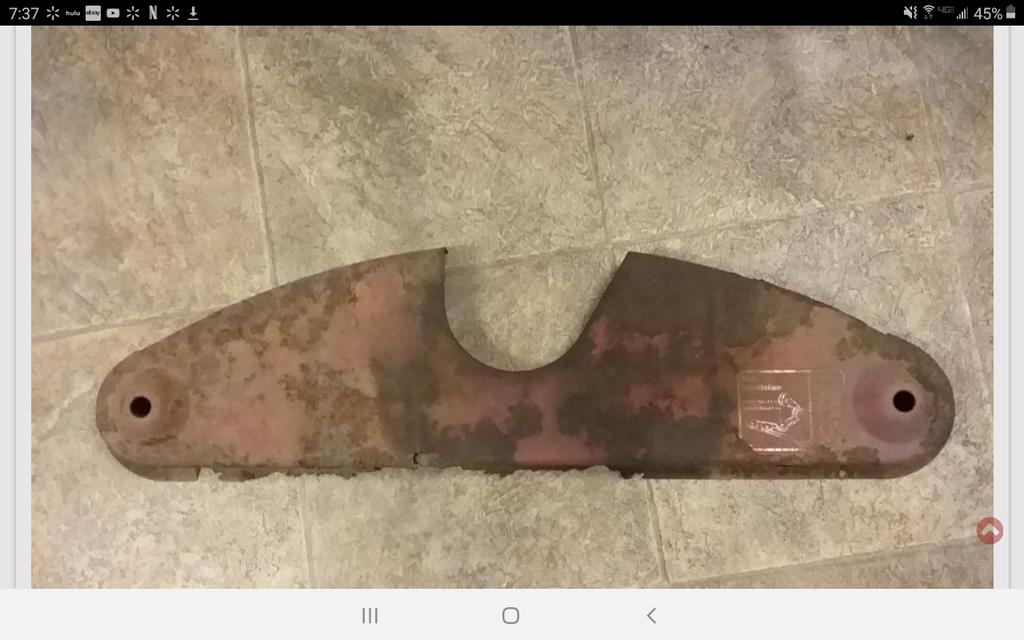

scwheelhorse 56 #1 Posted November 5, 2019 Will these 42 inch deck belt covers swap? The old rusted one is mine. The other a member here has. Can they interchange? 1 Share this post Link to post Share on other sites
daveoman1966 3,882 #2 Posted November 5, 2019 I will say YES. But you'll have to cut holes to access the grease zerks on the spindles...and... MAYBE trim the front for drive belt to clear the cover. Just use self-taping screws to bolt it down if the holes don't line up. Share this post Link to post Share on other sites
