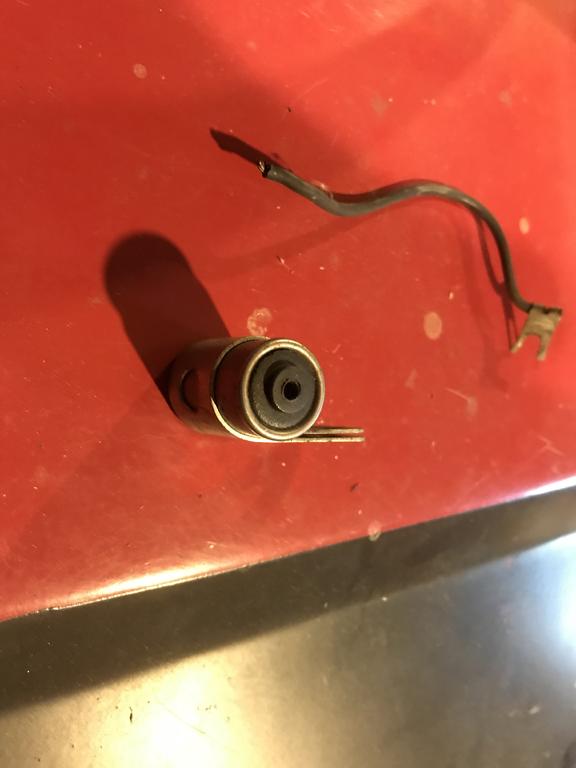

MalMac 1,333 #16 Posted November 6, 2019 The culprit 1 Share this post Link to post Share on other sites
tunahead72 2,581 #17 Posted November 6, 2019 Wow, that's your "new" condenser? Share this post Link to post Share on other sites
MalMac 1,333 #18 Posted November 6, 2019 Yep sure is. I went to take it off and the wire just fell off. There’s some quality right there I’ll tell ya. 🤬 Share this post Link to post Share on other sites

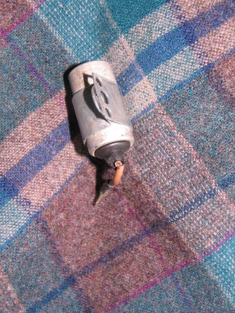

pacer 3,177 #19 Posted November 6, 2019 I can feel your frustration!! Was working on a B43 Onan with a weird problem - on/off starting prob, on/off running erratic, etc. Usually seeming mostly a carb problem and had been in/out of carb so many times it almost came apart when I removed itHad also been thru all ignition components about 3-4 times and also all the fuel delivery syst about that many I consider myself a pretty good 'shade tree mechanic' having been some 60+ yrs fooling with engines large and small, but I was almost ready to do an engine swap when I thought I would do ONE more 'go thru' Luckily? I started with another ignition ck and removed the points/condenser.... still looked just like the last time I looked at them .... but, on reinstall; I thought I saw a suspicious spot on the condenser, Pulled it back out and looked at closely .... hmmmm what is that tiny crack in the insulation? Kinda bent the wire and WHOA!! theres where the magic 'juice' was going. Was mounted really close to a bolt head that had all the engine heat and it had hardened the insulation and made it brittle and cracking allowing the magic to escape!! Quickly scrounged around and found another condenser, mounted it and HOORAY!! thing ran like a top 1 Share this post Link to post Share on other sites
