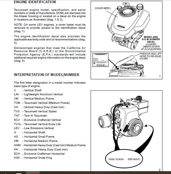

pfrederi 18,810 #2 Posted November 3, 2019 110 volt starter probably is a snowblower engine. Any air cleaner on it. (Blower engines do not have them) Could be 5 to 10 hp Id stamped into blower housing Share this post Link to post Share on other sites
whman01 15 #3 Posted November 3, 2019 Older Tecumseh engines had a metal tag riveted to the blower housing. Newer ones have the numbers stamped in the top of the blower housing. Newest engines have a plastic tag adhered to the housing. Bob 2 Share this post Link to post Share on other sites

6wheeler 669 #5 Posted November 4, 2019 On 11/3/2019 at 1:13 PM, pfrederi said: 110 volt starter probably is a snowblower engine. Any air cleaner on it. (Blower engines do not have them) Could be 5 to 10 hp Id stamped into blower housing Thanks guys. I found the number. It is an HM80. So, it is an 8 hp. I took off the carb. to clean it. Should be good to go after. Now, to find something that needs an engine............. Share this post Link to post Share on other sites
