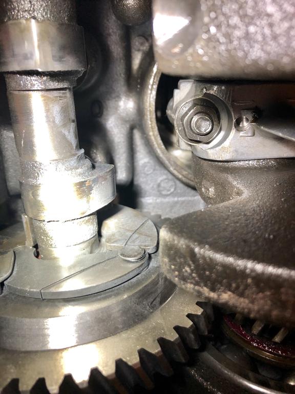

The Tuul Crib 7,340 #1 Posted November 3, 2019 As I'm tearing these motors apart and going through them one of the 16 horse that I'm working on I ran across the wires on the camshaft that were extremely brittle. It just disintegrated when I touched it. What is the purpose for these little pieces of wire on the camshaft? Do they serve a purpose? Share this post Link to post Share on other sites
pfrederi 19,289 #2 Posted November 3, 2019 ACR springs .. 1 Share this post Link to post Share on other sites
The Tuul Crib 7,340 #3 Posted November 3, 2019 1 hour ago, pfrederi said: ACR springs .. I thought that only the small block had this Can these be found at not a high cost? Share this post Link to post Share on other sites

The Tuul Crib 7,340 #5 Posted November 3, 2019 (edited) 15 minutes ago, Elliot Garfinkel said: I was looking for them also not sure if I need it but rather have and not use it.Does the other motor have it or are you doing one at a time.Do you have pull start .I guess if you have elec. You dont really need it. I am doing one motor at a time and I have another motor I can rob the part off of for now. I have found a part on eBay for around seven or eight bucks shipped to my house. You would think that this little tiny spring could be left out but what I am told it is important . These little springs are so so tender ! Edited November 3, 2019 by The Tool Crib Share this post Link to post Share on other sites

Guest 88vic #11 Posted November 4, 2019 Thats the compression release spring. With electric start you may not notice a difference but ......if it were a pull start, it would yank the rope out of your hand and that could sometimes hurt ! Lol Share this post Link to post Share on other sites
The Tuul Crib 7,340 #12 Posted November 4, 2019 OK so if I leave it out no worries . Share this post Link to post Share on other sites
