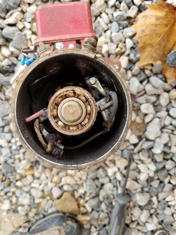

cafoose 3,670 #19 Posted October 28, 2019 I swapped out the S/G with another one and it cranked over but stopped cranking before it fired off just like before Then I took a battery I had on a battery tender that showed a green light and put that in. Still no cranking Then I put on all new battery cables and no difference I took my truck and jumped the battery and it fired right off I finished spreading the stone and shut it off now it will not start without a jump This is inside the old S/G Share this post Link to post Share on other sites
