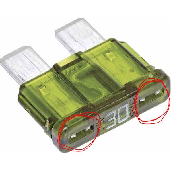

Macwrench 133 #9 Posted October 29, 2019 43 minutes ago, maclilly said: well I went out and bought new fuses even thou the old ones looked good, put in new ones and for some reason it came back to life, could I have a bad fuse block? it doesn't look corrorded the metal maybe a little dark Possibly, or just pulling it out and putting it back in fixed it. Dirty connections. If you look on the back of those ATC fuses, they have a bare spot on them (see pic). You can put a multimeter to that point and check them without removing the fuses. 2 Share this post Link to post Share on other sites

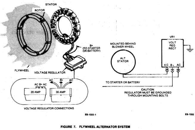

maclilly 2 #10 Posted November 2, 2019 can anyone tell me which wire goes where on voltage regulator old one fell apart theres 4 wires 3 terminals. can't seem to find a diagram anywhere thanks Share this post Link to post Share on other sites
lynnmor 8,265 #11 Posted November 2, 2019 2 hours ago, maclilly said: can anyone tell me which wire goes where on voltage regulator old one fell apart theres 4 wires 3 terminals. can't seem to find a diagram anywhere thanks Two wires come up from behind the flywheel to supply the charging current, those connect to the outside terminals. A gray wire piggybacks on either one of those two and is the pickup for the tachometer. Of course the remaining wire connects to the center one which is the 12 volt output. Be sure that the voltage regulator is properly grounded to the engine. Share this post Link to post Share on other sites
gwest_ca-(File Mod) 11,852 #12 Posted November 2, 2019 Post the model and serial number of the tractor and we can link you to the tractor wiring. Here is the Onan engine wiring for the charging system. If the tach does not work on one AC terminal try the other AC terminal. Believe it will only work on one of them. Garry 1 Share this post Link to post Share on other sites
953 nut 63,075 #13 Posted November 3, 2019 17 hours ago, maclilly said: can anyone tell me which wire goes where on voltage regulator old one fell apart theres 4 wires 3 terminals. can't seem to find a diagram anywhere thanks Not all voltage regulators on are the same, they changed over the years.. Please tell us what year and model you are working on. Share this post Link to post Share on other sites
