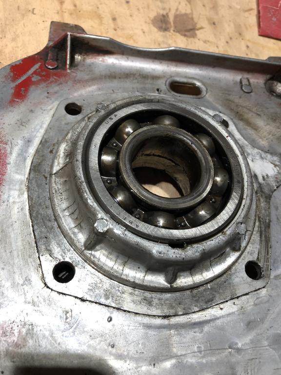

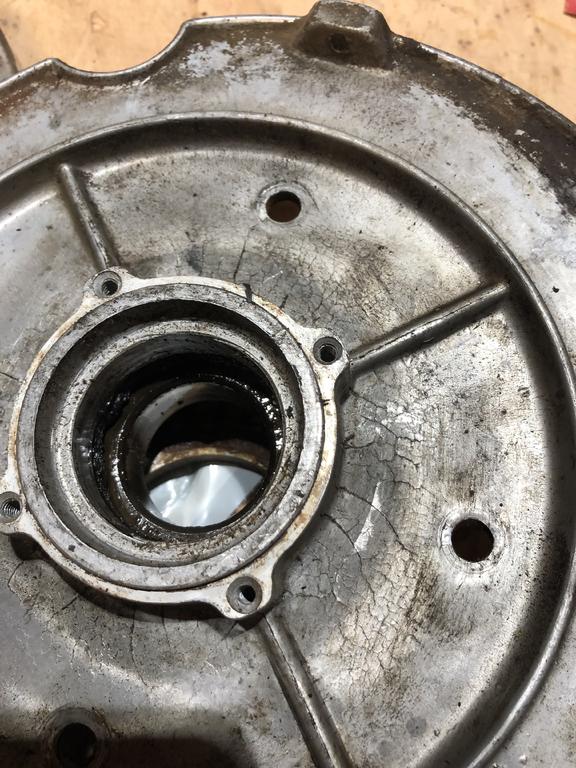

The Tuul Crib 7,354 #26 Posted October 29, 2019 (edited) Plan on that. It didn't have the tell tale Smell that you usually would get with a mouse nest. I will be tearing it down even farther and hone out the cylinder , put in a news set of rings , take out of course the balance gears and give it a good cleaning . I did find these cracks in the bearing plate in one of them. It looks like the bearing may have got hot at one point . Edited October 29, 2019 by The Tool Crib 1 Share this post Link to post Share on other sites

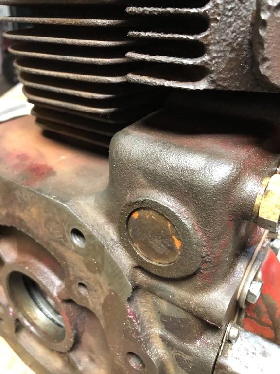

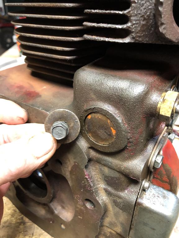

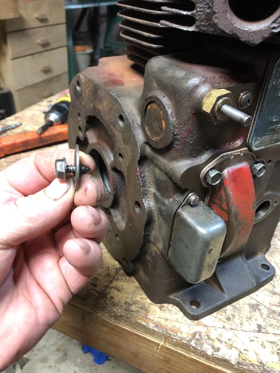

The Tuul Crib 7,354 #27 Posted November 5, 2019 Well I got to this point and found the screw that was driven into the Plug to the governor shaft. It appears that they were trying to bypass the governor and run this thing wide open. Duh! I had another plug off of another engine and pulled it out and replaced it and hopefully I can make this work . Share this post Link to post Share on other sites
