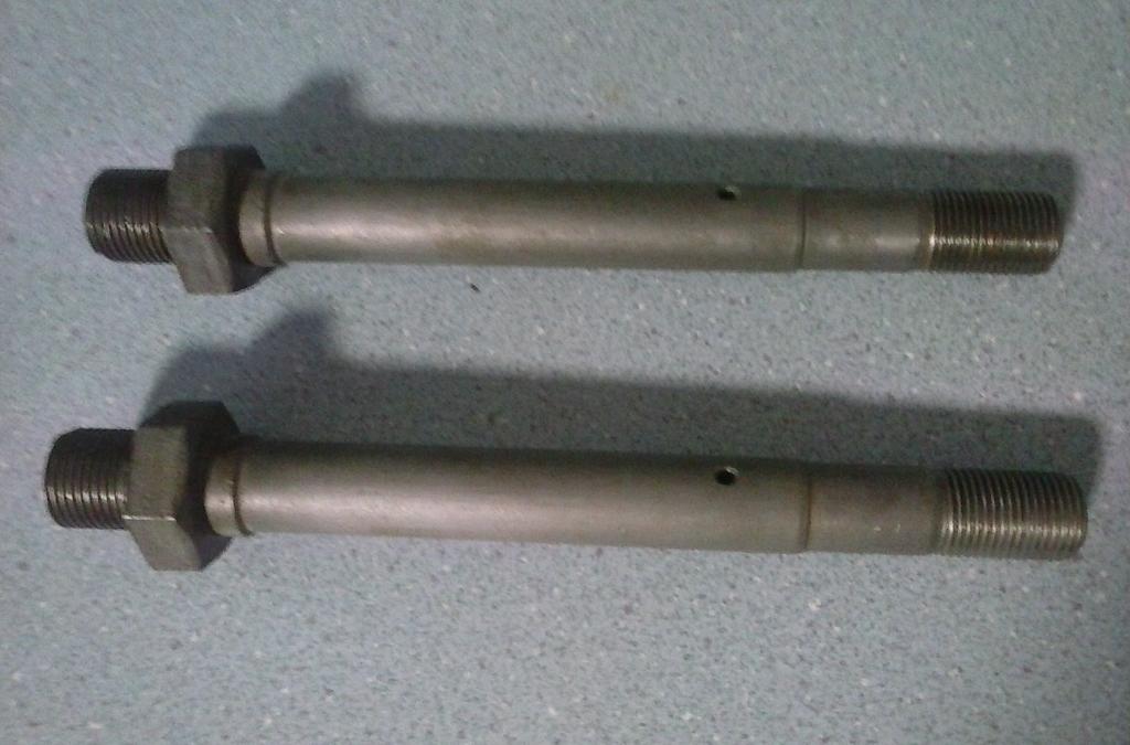

76c12091520h 4,119 #1 Posted October 21, 2019 Another piece floating around the bottom of a drawer: I know it's an outer spindle shaft, would like to know either a part # or application. I have some ideas what the part # may be but not having another one to compare it to isn't helping( they all look the same in the parts blow-ups and I can't find dimensions anywhere) piece measures 7 1/4" long , welded nut end is 3/4" , grease fitting end is 5/8" . Thanks again Share this post Link to post Share on other sites
daveoman1966 3,882 #2 Posted October 21, 2019 Those look like the shafts I need for my 42" deck.... what would it take to buy them from you... Paypal. 2 Share this post Link to post Share on other sites
Lee1977 7,571 #3 Posted October 23, 2019 Those are metric spindles the shaft where the bearings go are 17 mm. They fit all late model 42" and 48" decks. Part no. 112674. Share this post Link to post Share on other sites
76c12091520h 4,119 #4 Posted October 24, 2019 That's the part # I had in mind, thanks for the 2nd opinion. Share this post Link to post Share on other sites
