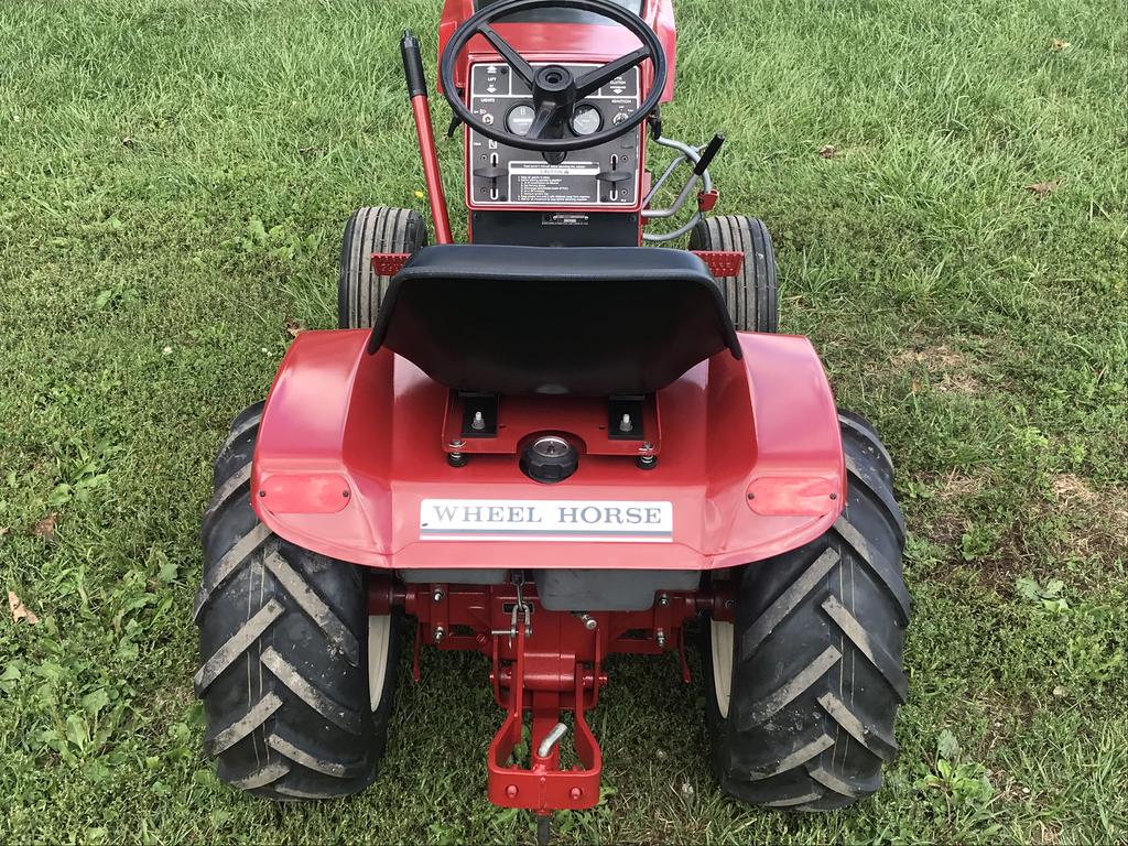

Pollack Pete 2,273 #2 Posted October 21, 2019 I,ve got a fender pan off a 300 series on one of my C-175's.Fit perfect and in my opion,looks much better than that plastic piece of crap.I'm sure others will also tell what will fit.Probably 400 and 500 series as well. 4 1 Share this post Link to post Share on other sites
Achto 31,004 #3 Posted October 21, 2019 (edited) Fenders from a 300, 400 ,500 series will fit & look pretty good. Fenders from a C series will also fit. The fenders on mine are from a C101. Edited October 21, 2019 by Achto 4 1 Share this post Link to post Share on other sites

WHX?? 54,997 #7 Posted October 21, 2019 Just out of curiosity Brian what ya think you have to have for it? Just got a new to me C-145 and Dan and I put a pan off a 520 and it fits perfect. Take longer to wire the taillights than anything. 1 Share this post Link to post Share on other sites

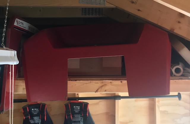

81blackhood 168 #9 Posted October 21, 2019 I hate the looks of the plastic fender. Mine was all busted up. Got this one off of a C-81 2 1 Share this post Link to post Share on other sites

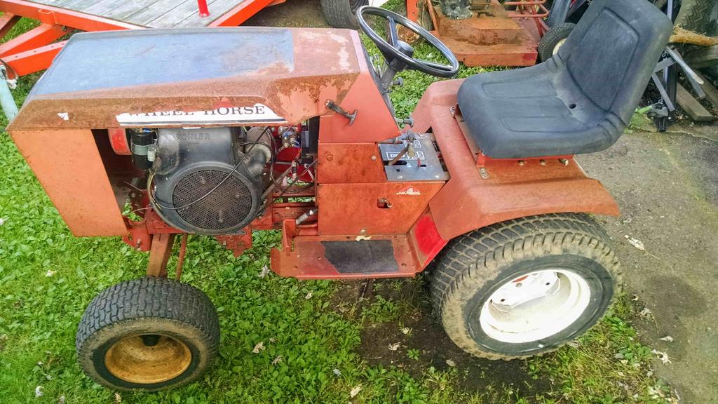

Stormin 9,987 #10 Posted October 22, 2019 My C-125 had the fender plastic replaced by a PO. Don't know off what, but I suspect a hydro. It has a square hole in the centre. Share this post Link to post Share on other sites

WHX?? 54,997 #12 Posted October 22, 2019 6 hours ago, Stormin said: It has a square hole in the centre. That would be correct Norm... square hole is for the hydro cam adjust. Under the seat anyway so mums the word. No I don't think it would fit @Gas Man Mounting & hole pattern is all together different. A fender pan off any model with the tank in the rear will line right up tho. Share this post Link to post Share on other sites
