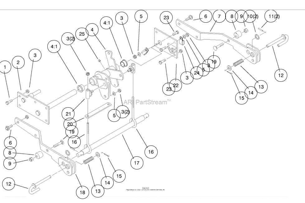

Texas Todd 1,025 #1 Posted October 18, 2019 (edited) Was mowing the other day and noticed the deck wouldn't come up. Upon inspection I noticed the two eye bolts facing the wrong direction with the nuts snapped off. Dug around and found the following graphic. #16 eye bolts are both broken (Toro #1045079). #20 strap was laying on the deck. #21's (Toro #942260) are no where to be found and according to the parts diagram at Jacks and a web search they are discontinued and NLA. Surely this has happened to someone else. A search of the forum did not reveal anything. Suggestions as to how to get this thing back in service? Thanks for any assistance. Edited October 18, 2019 by Texas Todd Share this post Link to post Share on other sites
gwest_ca-(File Mod) 12,015 #2 Posted October 18, 2019 Click on the picture. Download the Bellcrank kit 100-1583 Found this https://www.partstree.com/models/100-1583-toro-bellcrank-kit-for-5xi-series-garden-tractors/bellcrank-assembly-0/ Jacks https://www.jackssmallengines.com/jacks-parts-lookup/manufacturer/toro/attachments/100-1583-bellcrank-kit-5xi-series-garden-tractors Garry Share this post Link to post Share on other sites
Texas Todd 1,025 #3 Posted October 18, 2019 Thanks Garry. After looking at those diagrams I realized I was looking at the wrong two holes on the lift mechanism. The lift doo-dads were still mounted (had to lower the lift to see them) With luck only a couple of eye bolts will be necessary. Muchos Gracias! Share this post Link to post Share on other sites
