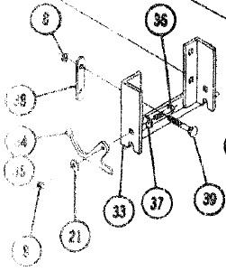

gwest_ca-(File Mod) 11,904 #3 Posted October 17, 2019 The early models like BD-4267 used a rear axle hitch that mounts ahead of the rear axle. You can see what it looks like in the illustrated parts list. Click on the picture. Garry 1 1 Share this post Link to post Share on other sites
Jhawkins 43 #4 Posted October 17, 2019 53 minutes ago, gwest_ca said: The early models like BD-4267 used a rear axle hitch that mounts ahead of the rear axle. You can see what it looks like in the illustrated parts list. Click on the picture. Garry Where can I find this mount? Share this post Link to post Share on other sites
gwest_ca-(File Mod) 11,904 #5 Posted October 17, 2019 The mount is part of the blade assembly so hopefully you can get it with the blade. Everything in the parts list came with a new blade. We often mention this because once the blade is removed from the tractor and sits in the corner before being sold the loose parts are separated from the blade and forgotten. Garry 1 Share this post Link to post Share on other sites
Jhawkins 43 #6 Posted October 17, 2019 I did not get it. Share this post Link to post Share on other sites
gwest_ca-(File Mod) 11,904 #7 Posted October 17, 2019 Try an ad in the classified section of the form. Hopefully another member has a spare they would part with. Use this picture if you want to show the style you need. Garry 1 Share this post Link to post Share on other sites

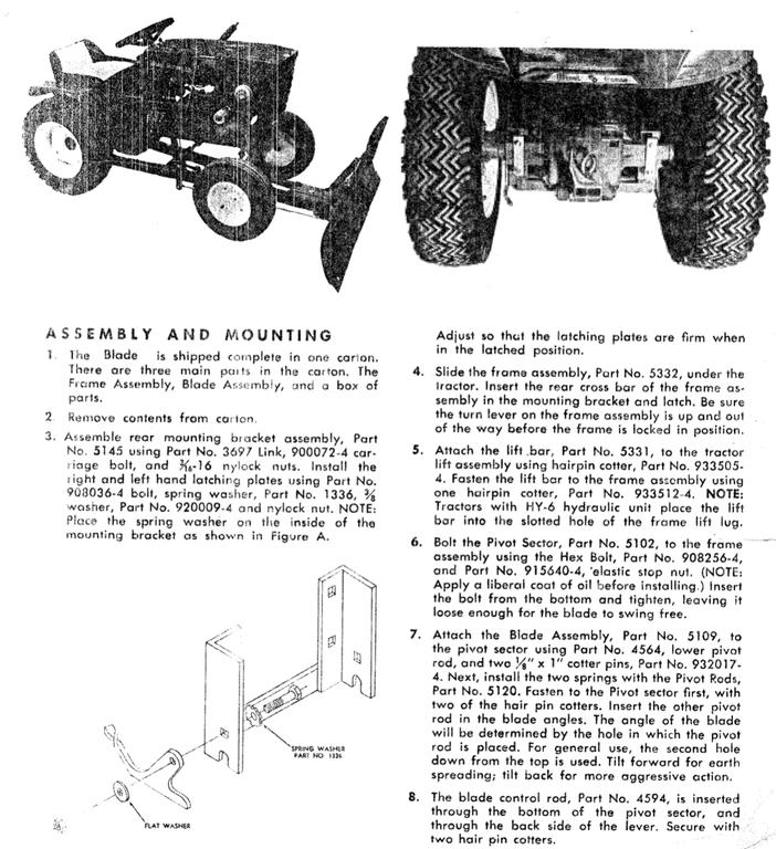

Pullstart 68,584 #8 Posted October 17, 2019 You learn something new every day! The manual shows the bracket... 1 Share this post Link to post Share on other sites
