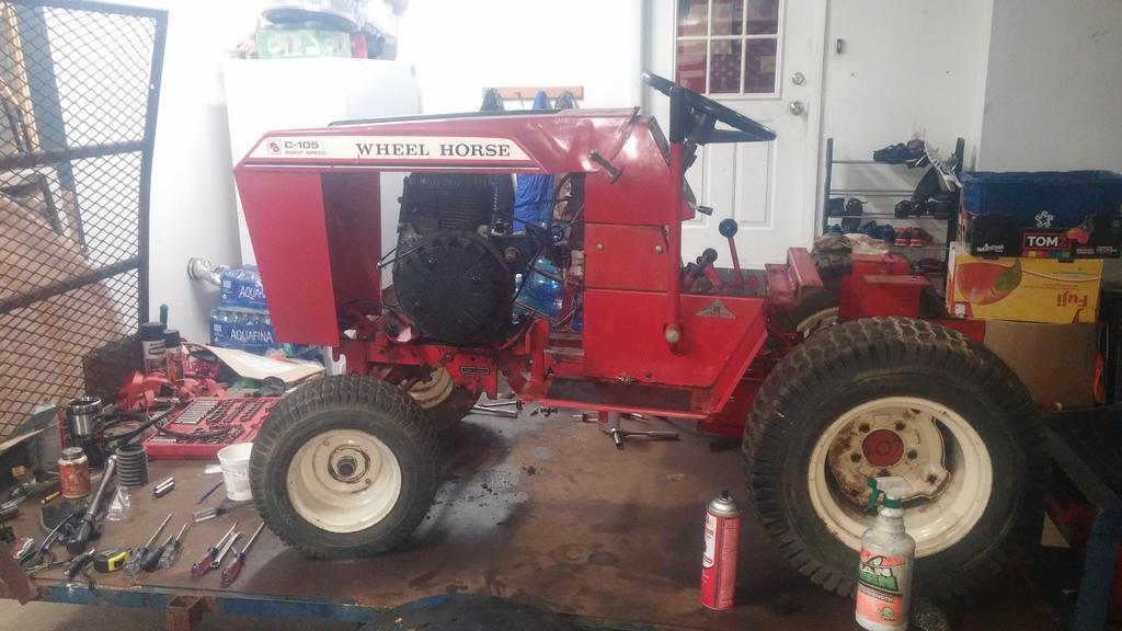

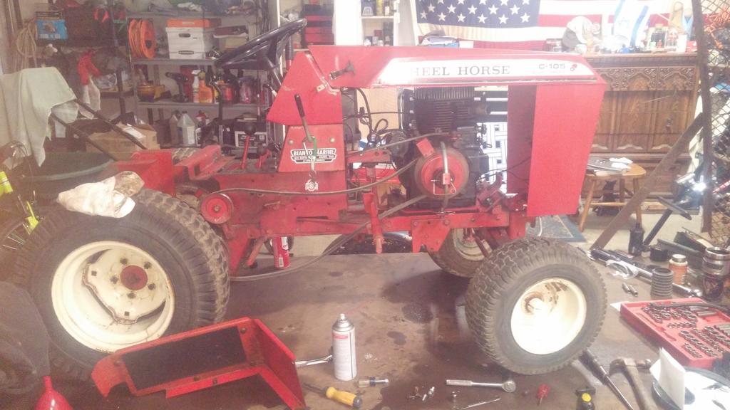

Newman38 12 #1 Posted October 13, 2019 Just found this for my son (12) who has been begging for a tractor for his "lawn/leaves/snow business" . He has been pulling everything around in our old red wagon. Gave it some time to see how serious he was and here we are. We bought this tractor, not running but turning over after researching and the praise this forum has given them. Was told mechanical fuel pump was bad and a electric one was put on and wired in to headlight switch for power ??? Also told would not start because the gentlemen thought carb needed adjusted and was fouling the plug out. It turned over pretty well so I told my son my thoughts but told him it was up to him. He said he loved it, let's get it and was very excited which impressed me. Got it home on the trailer and we started to investigate. Fuel system full of Brown gunk from tank to carb. Cleaning and redoing with a Faucet fuel pump from Kirk Engines and Dorman #55240 glass fuel filter. Now to the ignition system, ignition wire worn badly with boot half gone. Points had some build Up. After reading about Kirk Engines here I went and checked his site. Ordering parts list is --- 1) Trandenser II Electronic Ignition System: $35.00 (1) Bosch Blue Ignition Coil: $65.00 (1) High-Performance Ignition Wire: $8.00 (1) Genuine Kohler Breaker Points: $15.00 (1) Breaker Points & Cover Retaining Screw Kit: $2.00 (1) Facet Solid State Electronic Fuel Pump: $57.00 USPS Priority Shipping - $12.00 Total - $194.00 I thought this might be a good way to make this as bullet proof as possible for my son after some training. Also have a back plate for fuel pump, NGK 3212 and gas cap on the way. Any thoughts and/or guidance would be greatly appreciated. Still have receipts. Thanks 4 Share this post Link to post Share on other sites

Mikey the Monkey 701 #5 Posted October 13, 2019 dont be afraid to take carb apart, clean, and use a rebuild kit. Share this post Link to post Share on other sites
953 nut 61,929 #6 Posted October 13, 2019 Father/son projects are a great way to build lasting bonds. Sounds like you have a good plan for correcting these deferred maintenance issues, cleaning and tightening all electrical connections including grounds is a good idea also. 1 Share this post Link to post Share on other sites

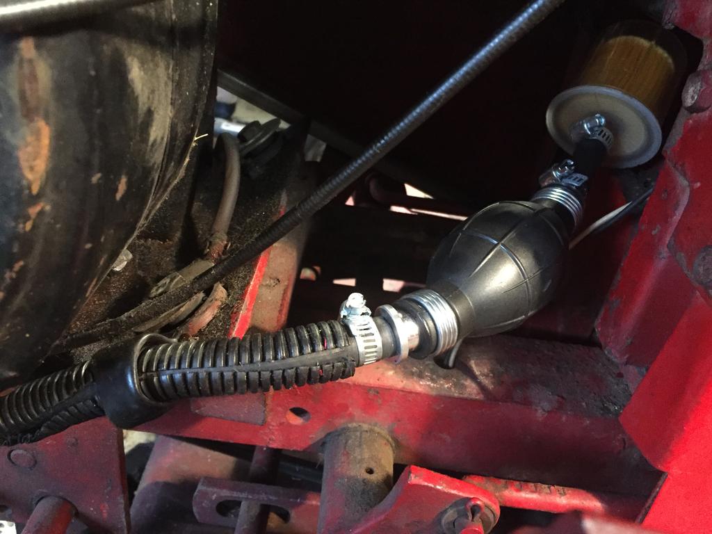

SylvanLakeWH 29,246 #7 Posted October 13, 2019 (edited) I love my C105s!!! Great tractors! You have a great plan! Make sure you really clean out the gas tank including the screen at the Shut off...all new fuel lines etc. I added a marine style pressure bubble to mine a month or so ago because it cranked too much on start even with a full tank. Wow what a difference!!! Fires right up now... Here’s a picture: Edited October 13, 2019 by SylvanLakeWH 3 Share this post Link to post Share on other sites

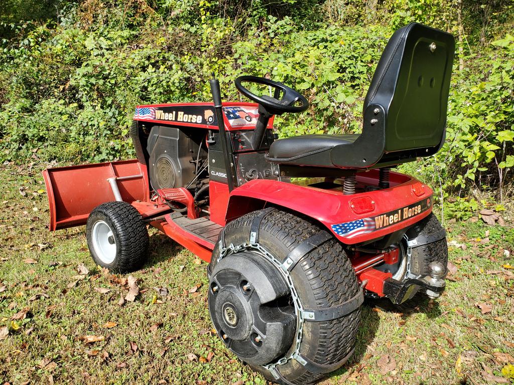

Newman38 12 #8 Posted October 13, 2019 Thanks. I did put a new shut off valve on tank after cleaning. That pressure bubble looks like a good idea, would that be useful with an electric fuel pump. Has anyone ever ran a strip of hard rubber or something on bottom of plow to help from catching raised edges. Also what tire chains would work best so my son doesn't tear people's drives up. I wasn't even sure if him using this to plow was a good idea because of traction and damage issues but he is really set on using. Share this post Link to post Share on other sites
SylvanLakeWH 29,246 #9 Posted October 13, 2019 Unlike most, I don’t run with chains for the very reason you mention. Many run the rubber chains with good results.I have heard that some run with a hard rubber strips or you could adjust it up a bit so it rides just above surface (that’s what I do) using adjuster knob lower left of shifters. Need to be very cautious doing other people’s drives with a plow. They will plow poor condition asphalt right up and will rip a garage door or siding right off if you clip it...but they work fast and great!!! Don’t know about your electric fuel pump q. Smarter folks than I hopefully will chime in... 1 Share this post Link to post Share on other sites

Racinbob 12,196 #11 Posted October 13, 2019 1 hour ago, Newman38 said: Thanks. I did put a new shut off valve on tank after cleaning. That pressure bubble looks like a good idea, would that be useful with an electric fuel pump. Has anyone ever ran a strip of hard rubber or something on bottom of plow to help from catching raised edges. Also what tire chains would work best so my son doesn't tear people's drives up. I wasn't even sure if him using this to plow was a good idea because of traction and damage issues but he is really set on using. With an electric pump you wouldn't need the primer bulb. I thought about one for my 05 and even bought one but ended up going with an electric. Best thing I've done to it. We're about to move to a place with a blacktop drive about 300' long. I just put these Terra Grips on it. The hard rubber edge on the blade sounds like a good idea. I may do that. 3 Share this post Link to post Share on other sites

Newman38 12 #14 Posted October 14, 2019 14 hours ago, SylvanLakeWH said: Unlike most, I don’t run with chains for the very reason you mention. Many run the rubber chains with good results.I have heard that some run with a hard rubber strips or you could adjust it up a bit so it rides just above surface (that’s what I do) using adjuster knob lower left of shifters. Need to be very cautious doing other people’s drives with a plow. They will plow poor condition asphalt right up and will rip a garage door or siding right off if you clip it...but they work fast and great!!! Don’t know about your electric fuel pump q. Smarter folks than I hopefully will chime in... I know, Its going to take some practice. Can't buy experience. Good to know the rubber ones are an option. Thanks for the tips. 1 Share this post Link to post Share on other sites
Newman38 12 #15 Posted October 14, 2019 12 hours ago, Racinbob said: With an electric pump you wouldn't need the primer bulb. I thought about one for my 05 and even bought one but ended up going with an electric. Best thing I've done to it. We're about to move to a place with a blacktop drive about 300' long. I just put these Terra Grips on it. The hard rubber edge on the blade sounds like a good idea. I may do that. Nice tractor.. So this is how they multiply.. I'm already thinking of a bigger one and still one on the trailer. Thats a nice fuel pump setup. Did you put a filter in also. Also the pump in getting says 7 gph, thats just what its capable of not what tractor would use correct. Is it a bad idea to drive this around town doing yards and driveways as far as wear and tear on the tractor. I assume it may use a lot of gas. Share this post Link to post Share on other sites

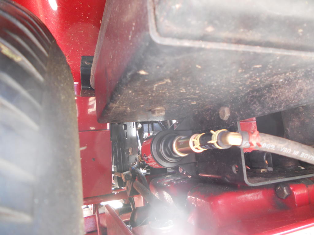

ZXT 2,401 #17 Posted October 14, 2019 3 minutes ago, Newman38 said: Nice tractor.. So this is how they multiply.. I'm already thinking of a bigger one and still one on the trailer. Thats a nice fuel pump setup. Did you put a filter in also. Also the pump in getting says 7 gph, thats just what its capable of not what tractor would use correct. Is it a bad idea to drive this around town doing yards and driveways as far as wear and tear on the tractor. I assume it may use a lot of gas. Once you get into them they definitely multiply! 7 GPH is what the pump can flow, not what the tractor will use. The tractor will not use anywhere near that much.. How big is town? It might use a little bit of gas but driving it shouldn't put any undue stress on the tractor. K241 and K301's are remarkably fuel efficient. 1 Share this post Link to post Share on other sites
Newman38 12 #18 Posted October 14, 2019 11 minutes ago, ZXT said: Once you get into them they definitely multiply! 7 GPH is what the pump can flow, not what the tractor will use. The tractor will not use anywhere near that much.. How big is town? It might use a little bit of gas but driving it shouldn't put any undue stress on the tractor. K241 and K301's are remarkably fuel efficient. Thanks. Towns only 1 square mile at that. He's probably working in a 10 by 10 block radius I'd say. Some days more some less. 1 Share this post Link to post Share on other sites

953 nut 61,929 #20 Posted October 14, 2019 6 hours ago, Newman38 said: Was reading on here how much the electric ones have helped so figured I'd give it a go. Not really sure on where or how to wire it. Last guy wired it to the lights If the pump is wired to the light switch feed (comes on when the key is on) and you don't have to turn on the lights for the pump to run then it is fine. 1 1 Share this post Link to post Share on other sites
Racinbob 12,196 #21 Posted October 14, 2019 6 hours ago, Newman38 said: Nice tractor.. So this is how they multiply.. I'm already thinking of a bigger one and still one on the trailer. Thats a nice fuel pump setup. Did you put a filter in also. Also the pump in getting says 7 gph, thats just what its capable of not what tractor would use correct. Is it a bad idea to drive this around town doing yards and driveways as far as wear and tear on the tractor. I assume it may use a lot of gas. Like ZXT said, the engine will only use what it needs. The pump I purchased came with a filter that threaded into the inlet side. You can see it in the picture. I just 'spliced' it into the fuel line under the seat. The line on the outlet side is as it was originally. Another inline filter and then to the fuel pump. I wasn't certain if I should bypass the original pump but to simplify things I did it this way and it works great. During the summer this tractor seldom sits more than a couple days but I could still see a marked improvement. In the winter it could easily sit 2-3 weeks and last winter I had a few times where I thought I'd run out of battery cranking it until the fuel completed the trip. I'm confident that won't happen this winter. Bad idea driving around town.....nope. Sure, there will be more hours put on the machine but that's what they are designed to do. The plusses that your son will see will far outweigh the added hours. 1 Share this post Link to post Share on other sites
ronhatch 407 #22 Posted October 19, 2019 Remember pumps push better then suck! So mount it as low and close to the tank As possible. I ran a new wire directly from the pump to the + battery post with an inline 3 amp fuse. . 1 1 Share this post Link to post Share on other sites
Newman38 12 #23 Posted October 20, 2019 11 hours ago, ronhatch said: Remember pumps push better then suck! So mount it as low and close to the tank As possible. I ran a new wire directly from the pump to the + battery post with an inline 3 amp fuse. . Thanks for that much needed info. Was wondering which option to use for power. Wouldn't running to the battery give continuous power or hurt battery though, I'm not sure. Share this post Link to post Share on other sites
Lee1977 7,368 #24 Posted October 23, 2019 I wired my electric pump with a fuse from the positive pump wire to the key switch. The pump ground wire trough a toggle switch and to ground. With the toggle switch on the pump starts and stops with the key switch. If it want to store the tractor for a while I can run it dry by turning off the toggle switch. 1 Share this post Link to post Share on other sites
