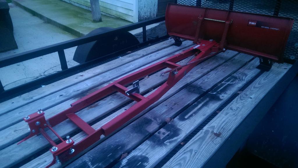

WarrenOstroff 0 #1 Posted October 12, 2019 (edited) I have an old 416-8 that was refurbished and given to me by a friend. I'd like to put a snow plow on it.... What info would i have to give you to tell me which one I need.... Edited October 12, 2019 by WarrenOstroff wrong model Share this post Link to post Share on other sites
WarrenOstroff 0 #2 Posted October 12, 2019 I have an old 416-8 that was refurbished and given to me by a friend. I'd like to put a snow plow on it.... What info would i have to give you to tell me which one I need.... Share this post Link to post Share on other sites
WVHillbilly520H 10,376 #3 Posted October 12, 2019 Just about any Wheel Horse snow plow made since 1973... They'll look like this. 1 Share this post Link to post Share on other sites
The Tuul Crib 7,339 #4 Posted October 12, 2019 8 minutes ago, WVHillbilly520H said: Just about any Wheel Horse snow plow made since 1973... They'll look like this. Share this post Link to post Share on other sites
gwest_ca-(File Mod) 11,440 #5 Posted October 13, 2019 Here is a list of them. Where 2 models numbers are shown one is the basic unit and the other is the completing kit to make it fit the application. 1968 model 6-4111 - First to fit LONG & SHORT frame tractors and first to mount under the rear axle - replaced by 1969 model [6-4112 + 6-9621] 1970-73 model [6-4113 + 6-9622] 1973-74 model [6-4113 + 6-9623] 1974 model [6-4114 + 6-9624] 1974 model 6-2131 1975 model 6-2132 1976 model 6-2133 1976 model 66-42BC01 1977 model 76-42BC01 1978 model 86-42BC01 1979 model 96-42BC01 1980 model 06-42BC01 1981-1984 model 06-42BC02 (Up to here they are 42" wide) 1984-1989 model 06-48BC01 (They are now 48" wide) - replaced by the following 1990 model 06-48BC02 1991-1993 model 06-48BC03 1993-2001 model 79350 2002 2004-2009 2012 model 79364 Garry Share this post Link to post Share on other sites
