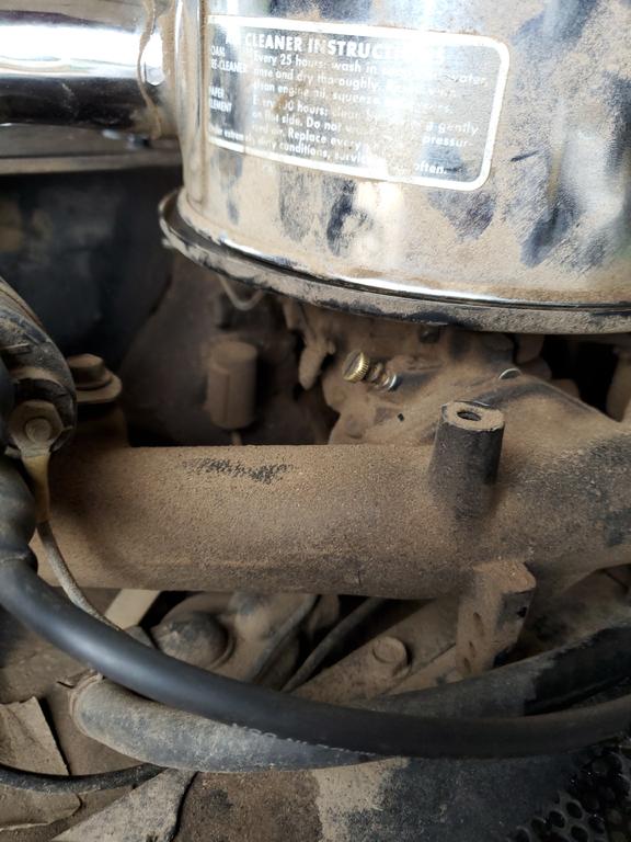

Jenna 6 #1 Posted October 12, 2019 My 417-a did not start easily. I changed spark plugs, airfilter, oil and fuel filter. It wouldn't turn over, put a new battery on. Same issue. Changed a fuses. Took air filter off tried again. Same wouldn't turn over. So I start looking around and I see a a screw with a spring on it. Under the air filter on the left side. I turn that a few times and lie and behold it works great now. What was it what did I do? 🤷♀️ Share this post Link to post Share on other sites
adsm08 3,616 #2 Posted October 12, 2019 Hard to say without a picture, sounds like one of the carb adjusting screws. Share this post Link to post Share on other sites
rmaynard 16,579 #4 Posted October 12, 2019 There is a huge difference between not "turning over", and "not starting". Sounds like your case was not starting, in which case the engine was cracking, but wouldn't start. In that scenario, you either had no spark, or no fuel. Turning the needle valve probably dislodged a piece of debris in the carb and allowed fuel to flow. Share this post Link to post Share on other sites

ZXT 2,401 #7 Posted October 13, 2019 Jenna, when you said it "wouldn't turn over", do you mean that the starter wasn't spinning the engine at all, or it just wouldn't start? Sounds like it initially wasn't spinning the engine over, since you changed the battery. If that was the case, maybe you have a loose electrical connection and you bumped something when you went to adjust the carburetor. Share this post Link to post Share on other sites
