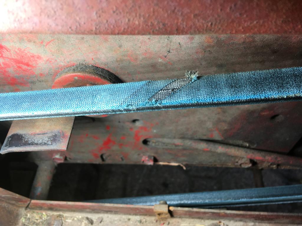

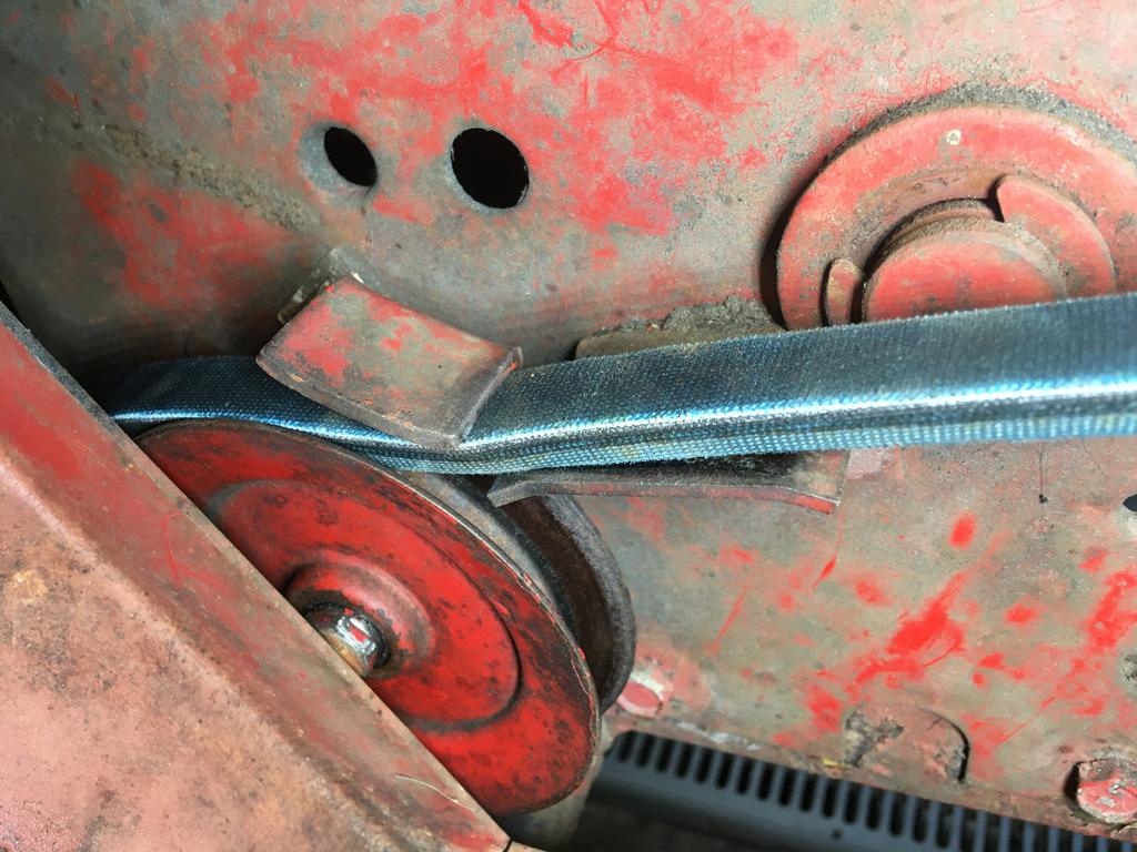

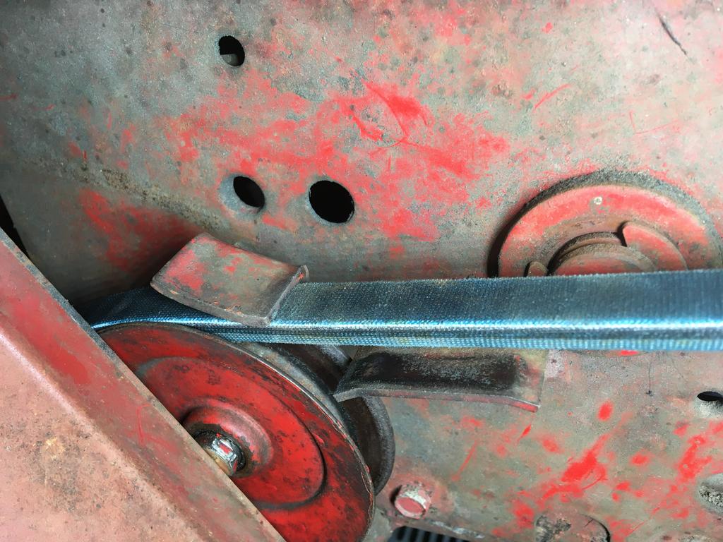

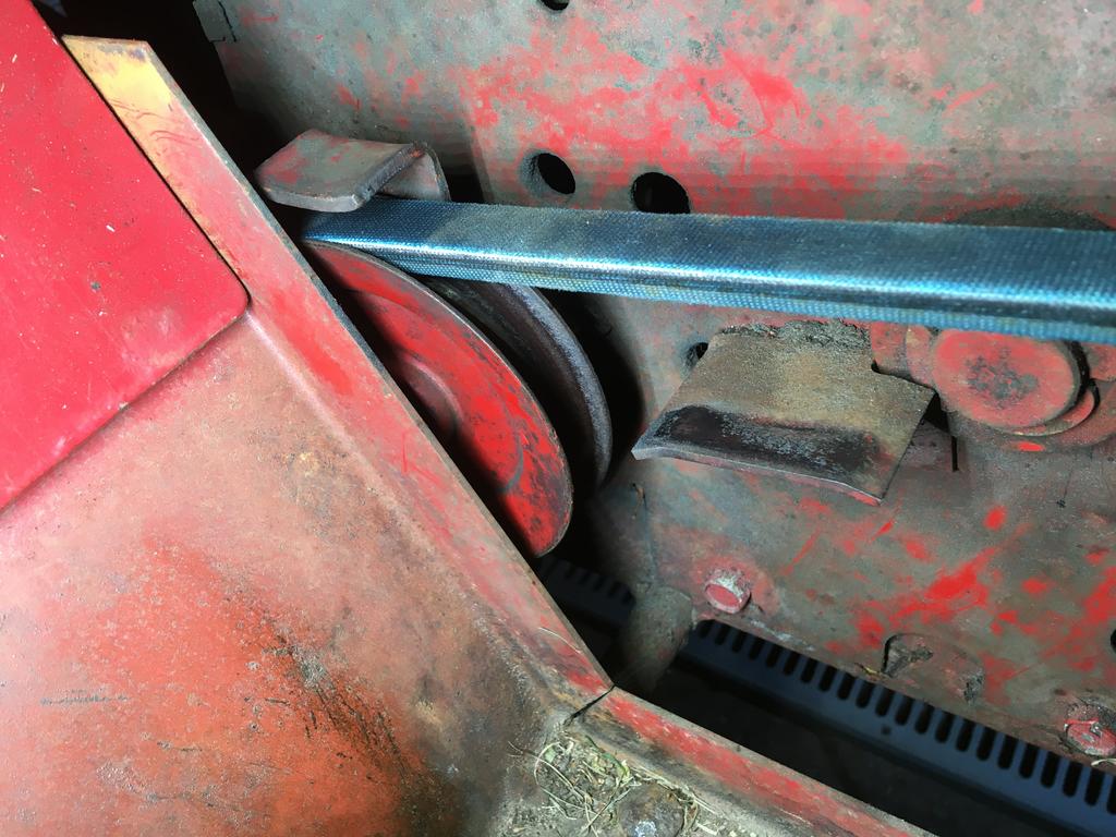

formariz 12,078 #13 Posted October 12, 2019 So here are photos of my problem. Also my belt is the correct length. I have no way to adjust bracket . It has no adjustment. First photo shows with clutch not depressed. Second photo half depressed. Third photo fully depressed pinching belt to a stop. Fourth photo damage to top of belt. Share this post Link to post Share on other sites

formariz 12,078 #15 Posted October 12, 2019 (edited) Part of the problem already starts on photo #2 with clutch partially depressed such as when wanting to move slower. Bracket contacts back of belt and creates friction on the belt wrap. It is clearly audible since wrap is textured. Nothing in that area has been modified. It seems intended to work this way, hence the second fixed bracket under the belt against which it is pinched. Edited October 12, 2019 by formariz Share this post Link to post Share on other sites
