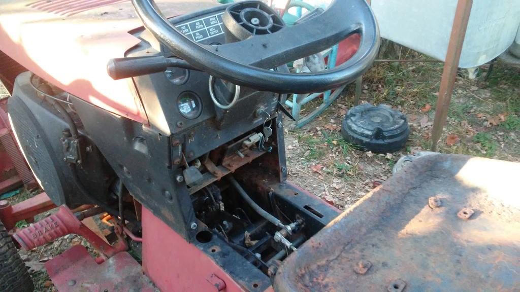

nyquil junkie 318 #1 Posted October 10, 2019 I got this one on trade, it starts, runs ok and moves around ok. The tires seem in good shape. I blew a fair amount of mouse nests and crud out of everywhere. All the wires have been cut out and a simple harness put in there to make it run and charge. None of the gauges sensors or safety switches work. (Who really needs safety switches anyway). Even though it moves around fine, there is no hydro fluid on the stick. I have a few questions about it... so here it goes. 1) On the air cleaner, there is a narrow vac hose that is on a brass orifice thing, its about a foot long and isn't connected to anything. What is it? Its not the "horsepower" gauge... its hooked up and actually works. I have no idea what this narrow vac line is. 2) The gas tank gauge wires are gone but the sender and gauge is still there. I don't know if they work but assuming they do, can it be hooked back up on its own some how? If so... how do I do it? 3) The transmission by the stick is empty... or at least so low its not on the stick. I doubt the thing has ever had the filters changed. I read along the way somewhere the hydro trans takes 5 qt of 10w30 motor oil with a filter, but I can't find what filter # it takes for the transmission. Anyone got a part #? The model# on the tag is 4120OE02 serial #1033294 just case it isn't what I think it is. The engine's tag is worn off. Here's some pics because why not. It came with a blade and a set of WH wheel weights. Not a bad trade. 3 Share this post Link to post Share on other sites

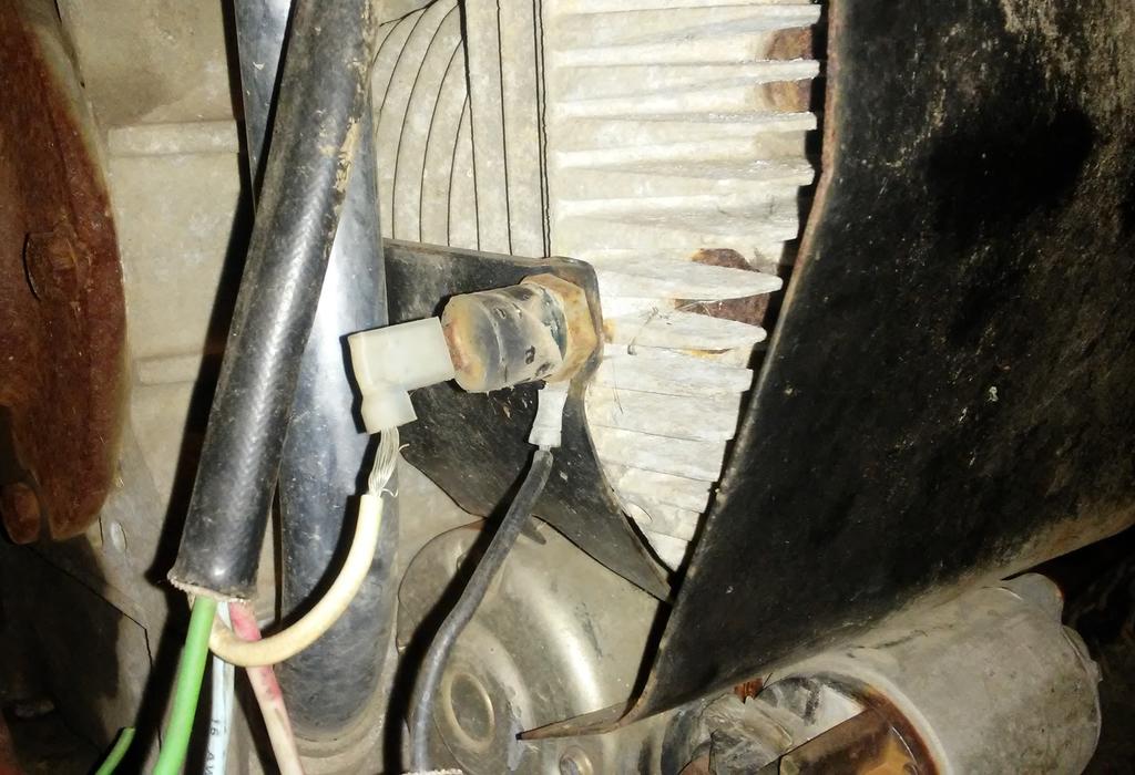

nyquil junkie 318 #2 Posted October 10, 2019 Also... What is this thing in the side of the engine head? Share this post Link to post Share on other sites

WVHillbilly520H 10,378 #4 Posted October 10, 2019 1 minute ago, nyquil junkie said: Also... What is this thing in the side of the engine head? Temperature sensor... You really need to pull the tins off the engine and give those cooling fins a really good scrubbing. 1 Share this post Link to post Share on other sites

nyquil junkie 318 #6 Posted October 11, 2019 Temperature sensor... You really need to pull the tins off the engine and give those cooling fins a really good scrubbing. What is the temp sensor for... was it on a warning light or something? I did take the tins off and took a wire brush to the fins. There was a ton of mouse fluff in there too. 1 Share this post Link to post Share on other sites

ZXT 2,402 #8 Posted October 11, 2019 (edited) Looks like you found yourself a diamond in the rough! A 520H is really the only "newer" WH that I have a craving for. I'd love to own one. As far as your fuel sender, I've never looked at one, but how many posts does the sending unit have on it? I'd assume it has one to ground the unit and one that runs from the sender to the gauge. I think if you hook one side of the gauge to the sending unit and hook the other to keyed power, it ought to work. I could be completely off here though. The temp sensor is obviously to tell you if the engine is too hot. This is most likely to happen if the tins are full of garbage. If you've cleaned them out, you should be good. Older WH's didn't have gauges. Keep everything clean and you should be OK without it. Edited October 11, 2019 by ZXT 1 Share this post Link to post Share on other sites
