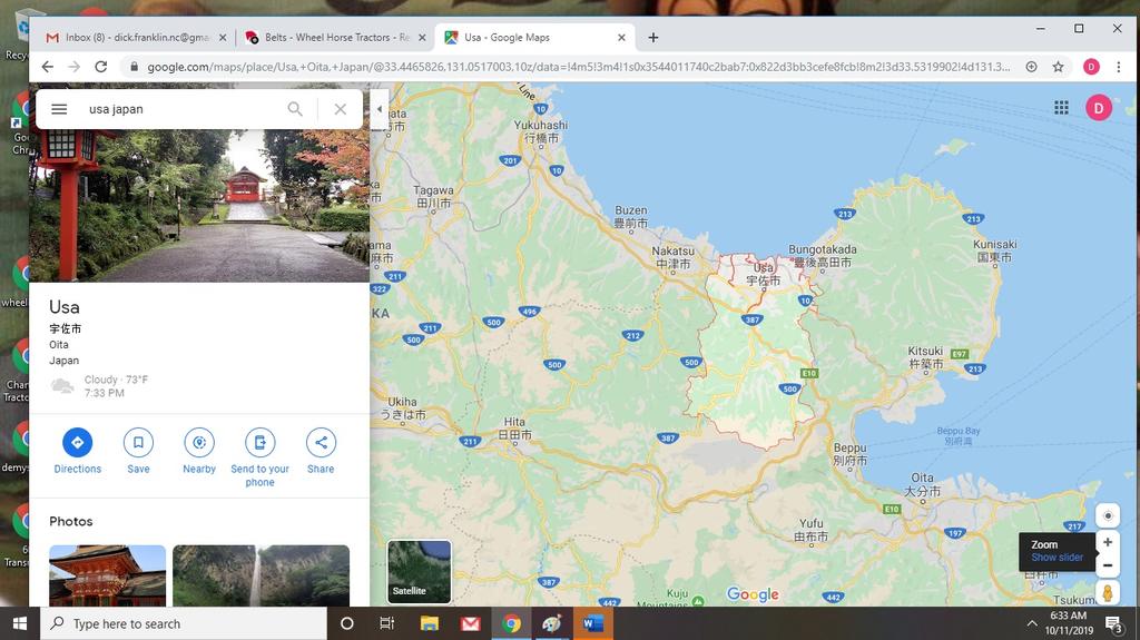

wallfish 20,733 #6 Posted October 11, 2019 9 hours ago, tom2p said: Listed as 'Made in USA' - but the belt I received was made in India. I remember something back in the day about Japan ? naming a town Usa, hence made in USA. Not sure if that was true or not. Maybe India did the same thing. 1 Share this post Link to post Share on other sites
ebinmaine 81,149 #7 Posted October 11, 2019 8 minutes ago, wallfish said: I remember something back in the day about Japan ? naming a town Usa, hence made in USA. Not sure if that was true or not. Maybe India did the same thing. I heard the same thing about Usa, China many moons ago. Share this post Link to post Share on other sites
953 nut 70,346 #8 Posted October 11, 2019 22 minutes ago, wallfish said: remember something back in the day about Japan ? naming a town Usa, hence made in USA. Not sure if that was true or not. Sad, but very true! Share this post Link to post Share on other sites
pfrederi 21,308 #9 Posted October 11, 2019 2 hours ago, 953 nut said: Sad, but very true! I had a small wind up metal car back then that was made in USA....Japan.... 1 Share this post Link to post Share on other sites
