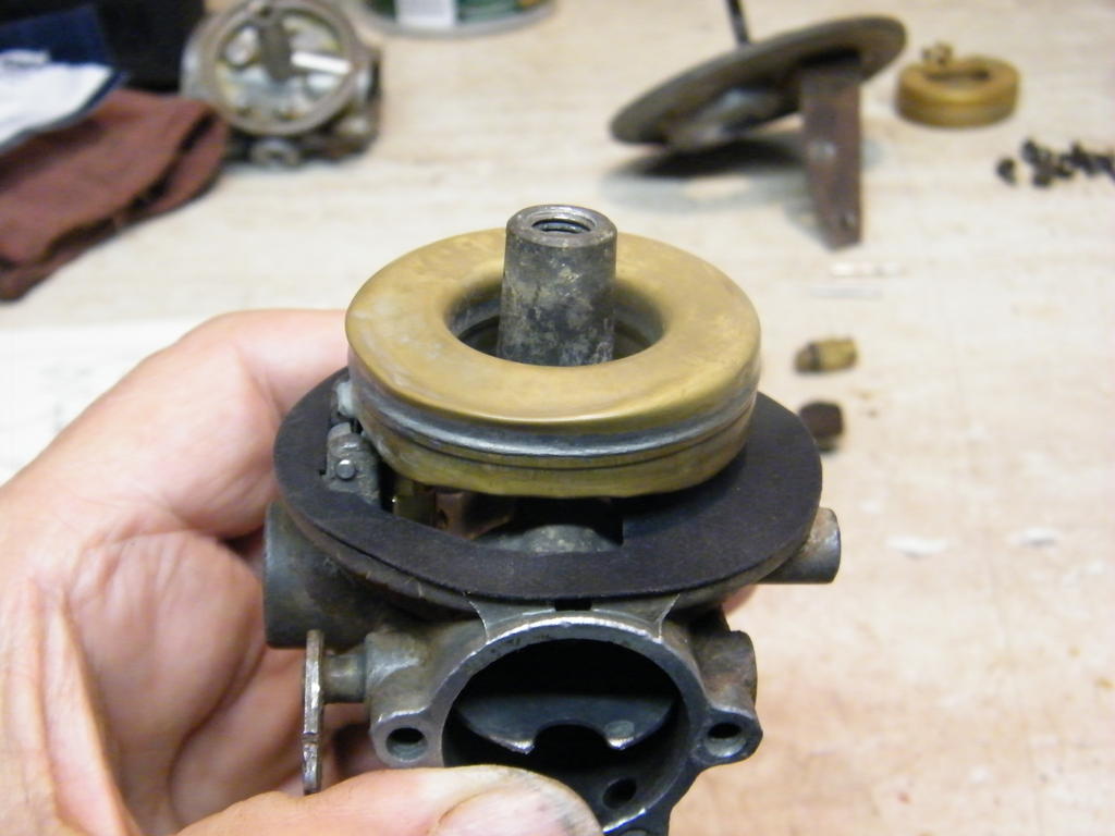

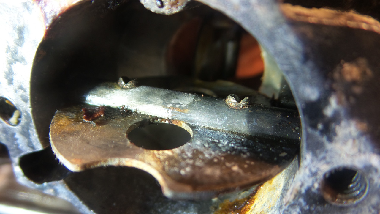

bc.gold 3,406 #27 Posted October 5, 2019 (edited) Those broken screws are best removed going forward as the screws are split then spread to keep them from coming loose. Instead of replacing the screws with new ones use a thread locker on the old screws to secure them in place. The image below taken from a C-275369 with a broken throttle shaft. Edited October 5, 2019 by bcgold Share this post Link to post Share on other sites

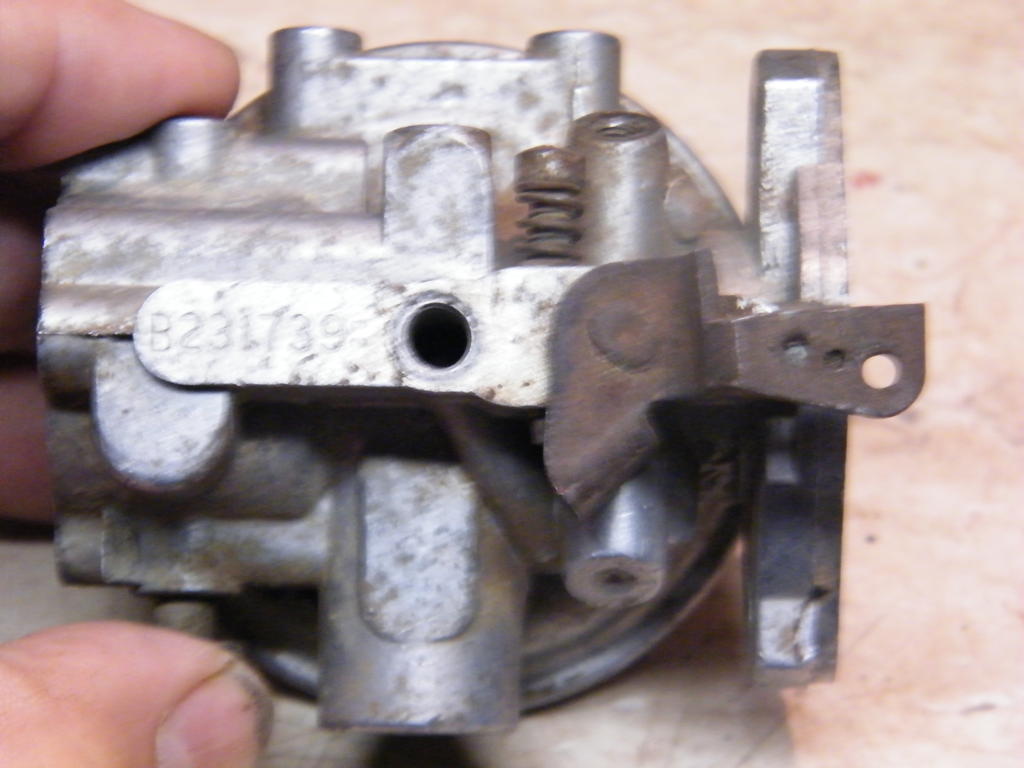

scwheelhorse 56 #28 Posted October 5, 2019 (edited) 5 hours ago, oldredrider said: Check for numbers on the mounting flange too. Numbers or letters on the throttle plate help too. I've got throttle plates if you still want one. Let me know. Yeah I need a plate but dont know what's fits it. This one is missing. I wonder if a plate from a china carb will fit? Edited October 5, 2019 by scwheelhorse Share this post Link to post Share on other sites

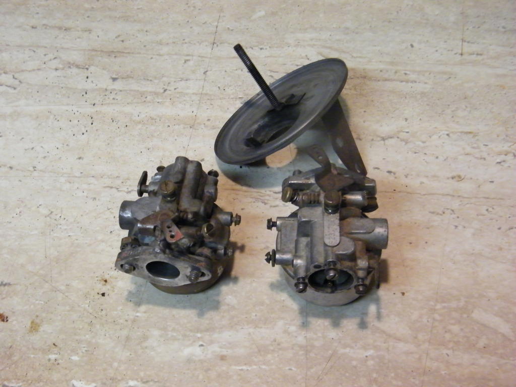

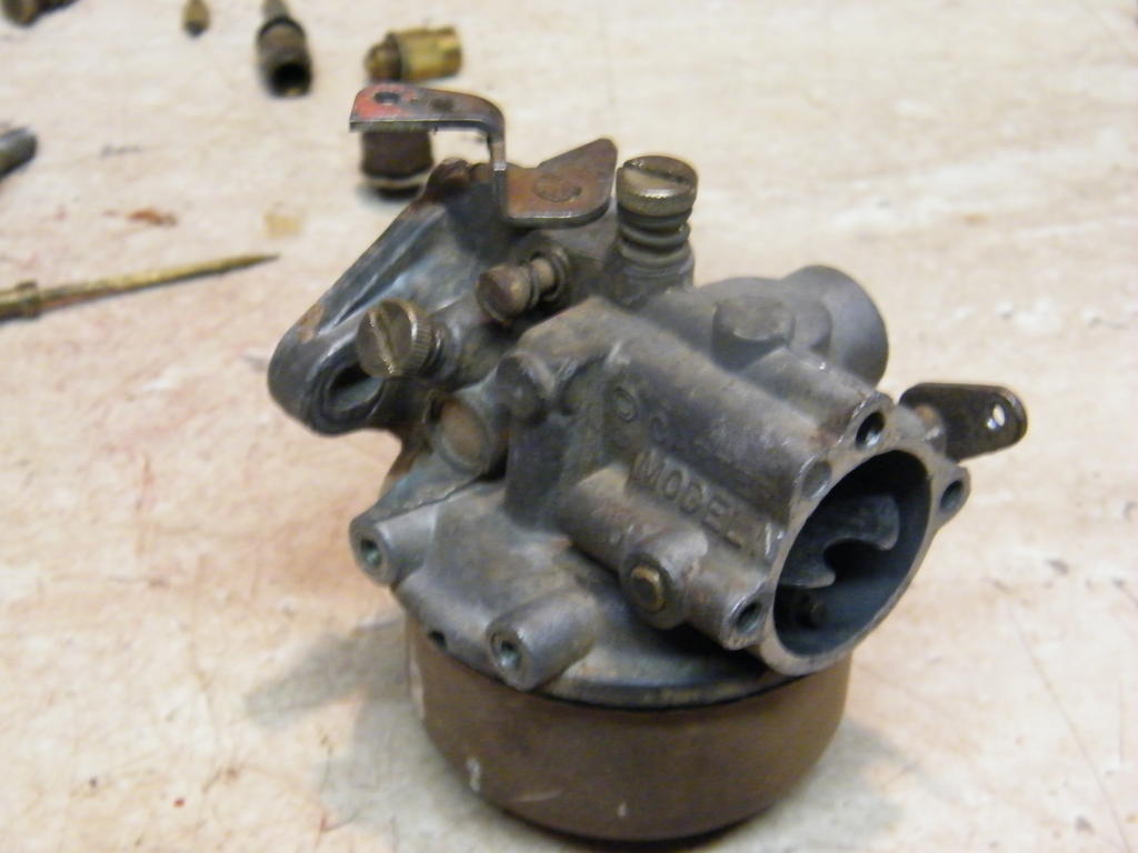

stevasaurus 23,857 #32 Posted October 5, 2019 I found some pages from a service manual that basically say the your K301 came with the Carter "N" carb. If not original, it may be a Kohler side draft carb. It kind of looks like a carter "N" and it has the open, slot ends where it bolts to the block. It was used on K-361 engines. If you have a good library near you, you might go in there and check out their sections on small engine manuals & Chiltons. It's the older stuff you can't find on the net. That is the best advise there is. Share this post Link to post Share on other sites

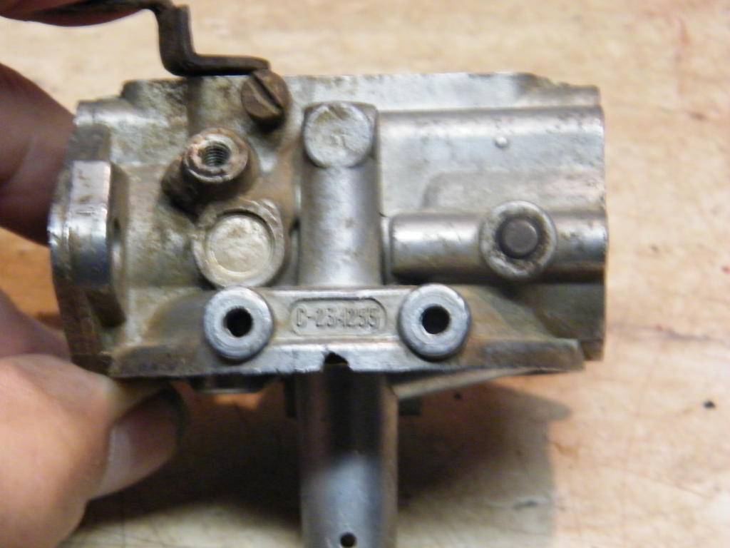

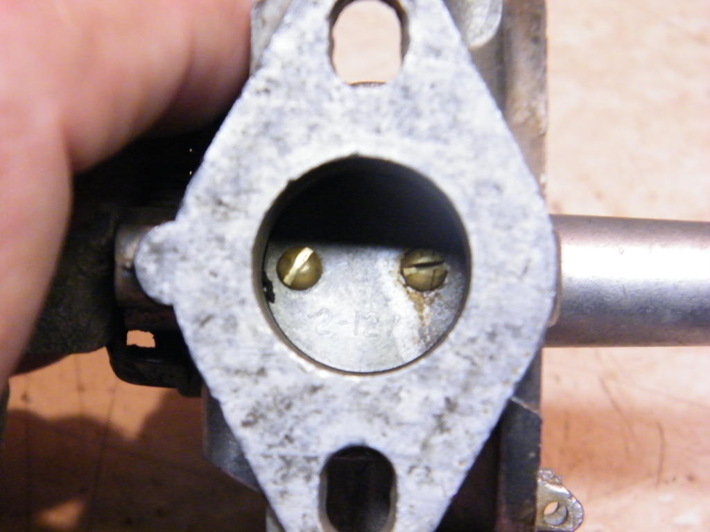

stevasaurus 23,857 #33 Posted October 5, 2019 Maybe this will help. The throat on my Carter "N" where the throttle plate goes...measures .827" and the number on the plate is 2-127 as seen in my 1st picture at the top of this page. Share this post Link to post Share on other sites

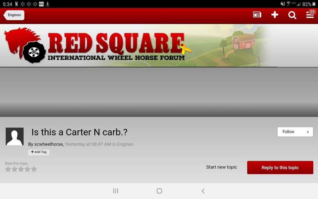

scwheelhorse 56 #34 Posted October 5, 2019 1 hour ago, stevasaurus said: your messages are at the top left on any page...looks like an envelope and you should have a 1 just above it if you have a message in que. No I dont see any envelope anywhere.. 1 hour ago, stevasaurus said: Share this post Link to post Share on other sites
pfrederi 21,196 #35 Posted October 6, 2019 Are you using a phone or something??? Might try the 3 bars or the plus phones an tablets hide stuff. i(I do not use those things). if you use a computer you should see something like this. 1 Share this post Link to post Share on other sites
