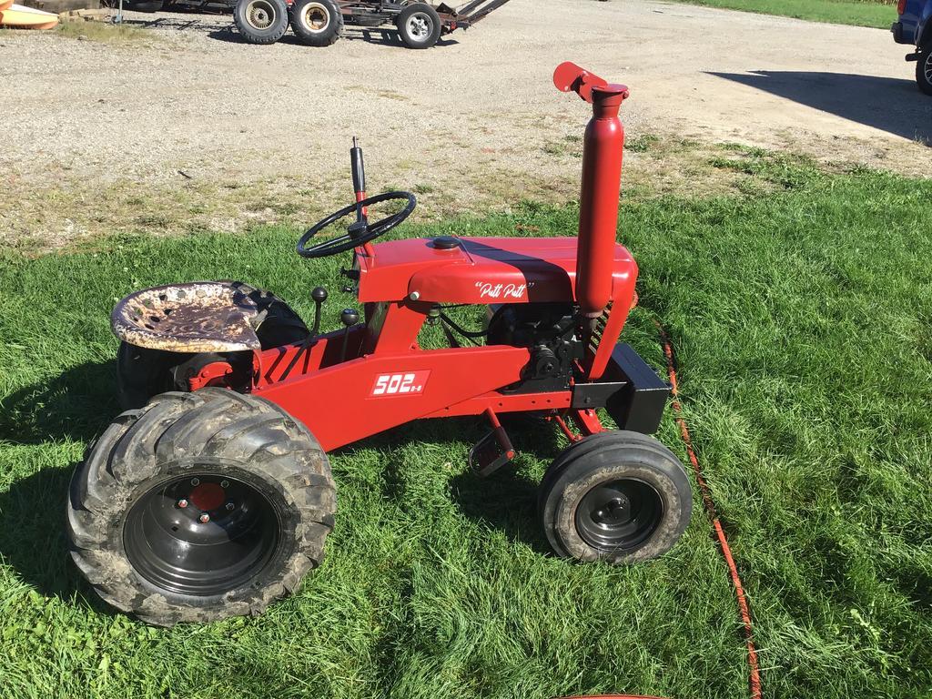

Pullstart 70,103 #45 Posted October 4, 2019 30 minutes ago, scwheelhorse said: WHs around here are pretty rare so I am very pleased to have saved this one. Just doing a "working resto" and putting her to work. Trying to hunt down an inexpensive coil locally but these parts stores seem to hire ex Walmart employees who dont know anything except what the computer says. Found one with good reviews on Amazon for 26 bucks speced for the Kohler so buying that one. The deals pop up once in a while, many times people think their tractor is worth a mint too. Here are a few of my favorite pictures of friends and family with the tractors. There are some before and after pics of my 502 we call Putt Putt too! Just a forewarning, they are indeed addictive! Share this post Link to post Share on other sites
