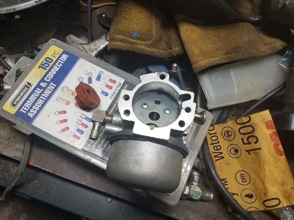

Mudrig150 386 #1 Posted October 1, 2019 (edited) So I've been working on my K241, I have a 30mm walbro carb on it, but we need it for our new cub, plus I did find the original carter 26mm carb. Brand new from Kohler still in the bag, but the previous owner broke the choke shaft in two and buggered up the throttle shaft screws. I want to rebuild it, and I have the butterfly plates, but I'm stumped as to where I could find the choke shaft and the screws. I might just buy a new carb and steal them from it, because honestly, I don't trust the 30$ amazon carbs. What do you guys think? Edited October 1, 2019 by Mudrig150 Share this post Link to post Share on other sites

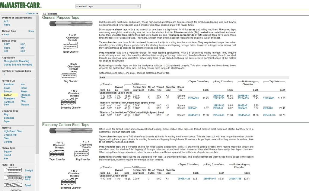

Mudrig150 386 #9 Posted October 3, 2019 Where is the best place to get a 4-40 drill and tap set? Every set I've seen have 2 kinds of reviews: A-They used it once and it worked. B-They used it a few times and it broke. Share this post Link to post Share on other sites

Mudrig150 386 #12 Posted October 3, 2019 (edited) 23 minutes ago, richmondred01 said: These will last. Snapon. https://shop.snapon.com/categories/629460 We already have a set of them. We're just missing the smallest taps (because of course we are). I just need the 4-40 tap and drill bit. 4-40 is a 1/4 hole size, right? Edited October 3, 2019 by Mudrig150 Share this post Link to post Share on other sites
Howie 900 #13 Posted October 4, 2019 No, went out and looked at my chart a 4-40 takes a #43 drill bit. That is .089 thousands. Share this post Link to post Share on other sites
Mudrig150 386 #14 Posted October 4, 2019 9 hours ago, Howie said: No, went out and looked at my chart a 4-40 takes a #43 drill bit. That is .089 thousands. Tap will be hardest thing to find, I presume. That'll take some looking to get a good one. Share this post Link to post Share on other sites

Mudrig150 386 #23 Posted November 6, 2019 (edited) Finally got the carb rebuilt. Used my mini vice-grips and a 3-48 tap to clean out the throttle shaft holes, then drilled out and changed the choke shaft holes to 4-40. Everything went together nicely, with no busted bits or taps, and the only mishap was a crookedly drilled choke screw hole, which I'm not worried about. Might end up pulling the screws back out and putting some thread-locker on them, so they don't get ingested by the motor. Ended up going for: 2 drill bits, .089" 100 4-40x1/4" thread making screws (choke shaft) 2 taps, 3-48 100 3-48x1/4" slotted screws (Throttle shaft) 2 bits and taps in case one breaks off, and 100 screws to do other carbs. Edited November 6, 2019 by Mudrig150 1 Share this post Link to post Share on other sites
