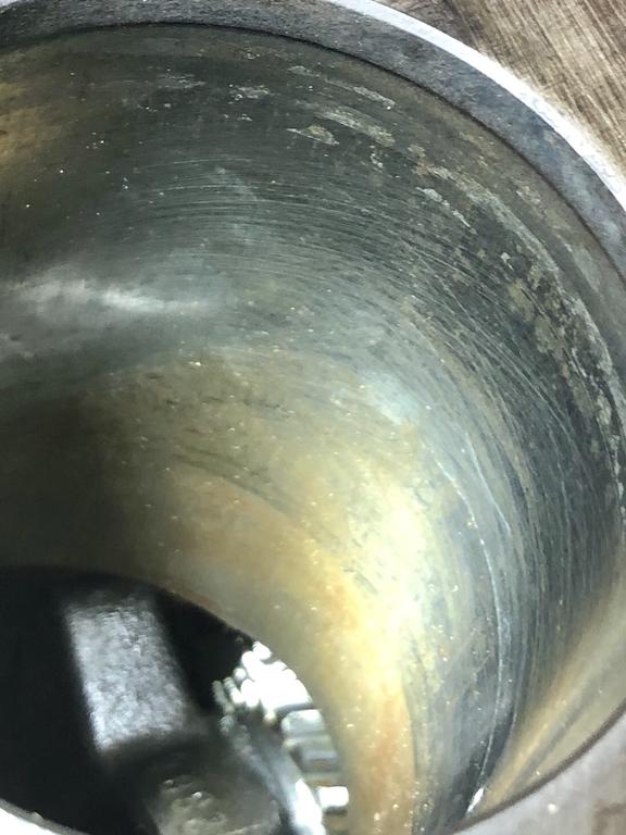

Burnerman 759 #27 Posted October 1, 2019 1 hour ago, The Tool Crib said: OK so I got home flipped the motor over took the rod cap off and pulled the piston out. Problem solved the crank turns freely once again. Now. Looking in the cylinder I can still see the crosshatches. The piston is stamped STD. My thought is to hone it out a little put new rings in it and I'm good to go Is that a ridge across the top of the cylinder or just the pic? Share this post Link to post Share on other sites
The Tuul Crib 7,340 #28 Posted October 1, 2019 33 minutes ago, Burnerman said: Is that a ridge across the top of the cylinder or just the pic? No ridge at all . I dont think this motor has many hours on it. 1 Share this post Link to post Share on other sites
Tractorhead 9,216 #29 Posted October 2, 2019 (edited) Hi crib, has the Piston a sign on it like a arrow or similar on top, that faces to one side? lot‘s of engines i rebuild has such a sign on the Piston, this must be shown faced to outlet. (Depending on engine Manufacrurer) while you didn‘t see ridges or marks in bore, maybe piston was inserted opposit as reason for your 90deg. Trouble. just as a suggestion to check. Because you told, while piston was out, the cam rotates freely. Edited October 2, 2019 by Tractorhead Share this post Link to post Share on other sites
