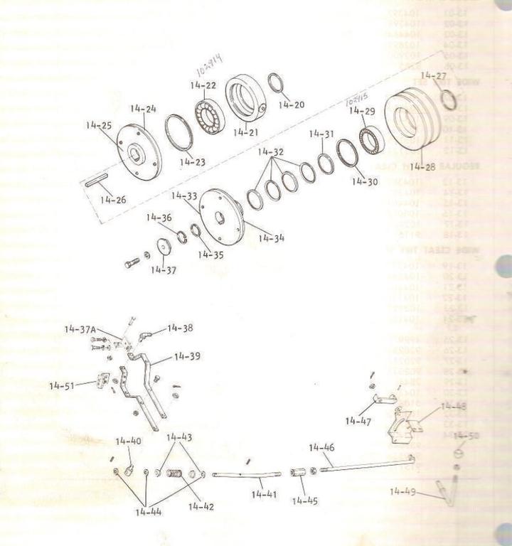

jammankel 24 #29 Posted October 5, 2019 its home now. we investigated the clutch slipping and part #103036 was broke so we welded it together so thats good now. it runs the pump for the bucket fine but when i went to try the tiller the clutch slips. i believe it glazed bad. what would you guys recommend for a new clutch? do you think it is something else? 2 Share this post Link to post Share on other sites

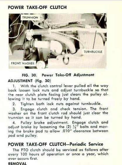

pfrederi 20,870 #30 Posted October 5, 2019 First try to adjust the PTO If it still slips do the 100 hour service of the PTO Shown in the owners manual. Share this post Link to post Share on other sites
jammankel 24 #31 Posted October 5, 2019 will be back to report shortly Share this post Link to post Share on other sites
jammankel 24 #32 Posted October 5, 2019 it works a lot better now still slips a little so i will need to do something at some point but for now it'll do Share this post Link to post Share on other sites

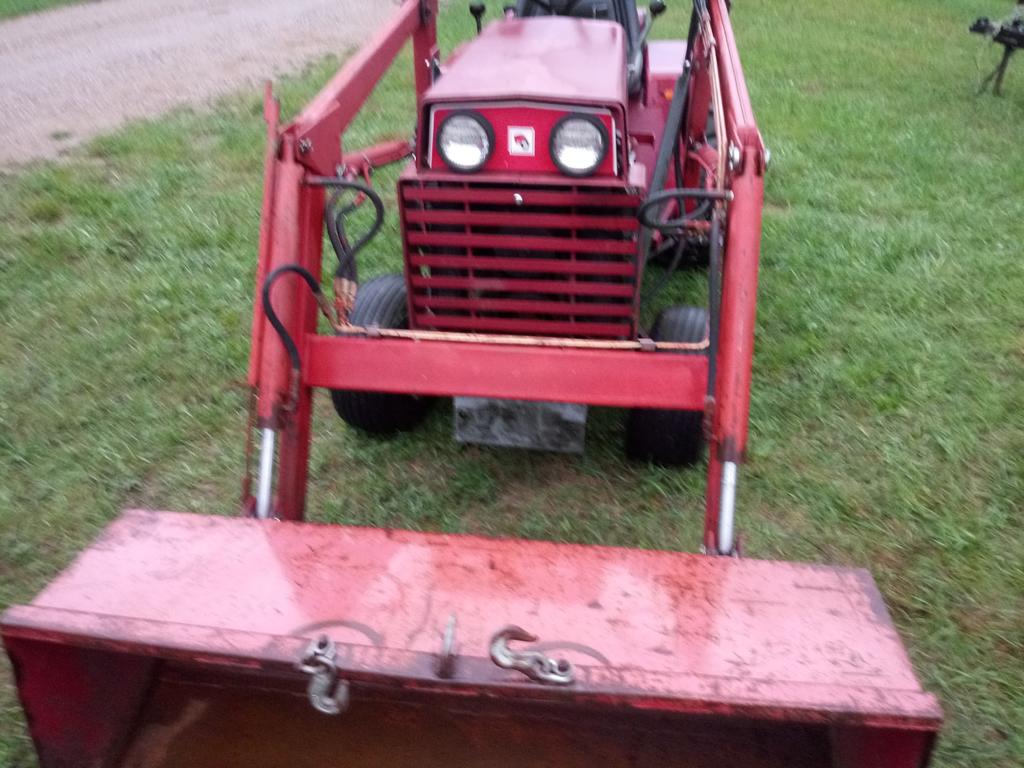

roadapples 6,987 #33 Posted October 6, 2019 I would remove those hooks or at least move them to the corners. You can bend the center of that bucket. Don't ask me how I know.. Share this post Link to post Share on other sites
jammankel 24 #34 Posted October 6, 2019 this morning i was playing with the bucket and the hook assembly for the clutch broke again do those brake often or is it just bad luck?(i welded it after the first time and it broke just before the weld the second) Share this post Link to post Share on other sites
pfrederi 20,870 #35 Posted October 6, 2019 4 minutes ago, jammankel said: this morning i was playing with the bucket and the hook assembly for the clutch broke again do those brake often or is it just bad luck?(i welded it after the first time and it broke just before the weld the second) Which part are you breaking??? Share this post Link to post Share on other sites
pfrederi 20,870 #37 Posted October 6, 2019 Not something I have heard of breaking before. Lincoln at AtoZ can probably fix you up. Share this post Link to post Share on other sites
