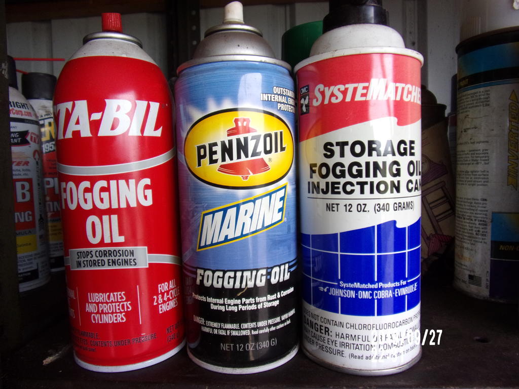

  BTW. What's this Fog oil? Never heard of it here.

Tractorhead
With „fog oil“ i mean a extremly Thin oil with strong creeping, what is mostly delivered in a rattlecan.
(not WD40)
The basic use was to let strong rusted parts become again movable (what also WD40can do)
but in WD40 is no Oil in.
Mostly in „Fog oil“  as i meant, is a bit MoS2 in to protect surfaces and give them a better lubrication.
i guessed this is the same stuff.
you can get it also in bigger Can‘s and use it by an Airgun with a spraybottle below.
i mix it with 2 stroke oil in relation 6:1  for firstly quicker contamination, the 2 stroke Oil is for longlife protection.

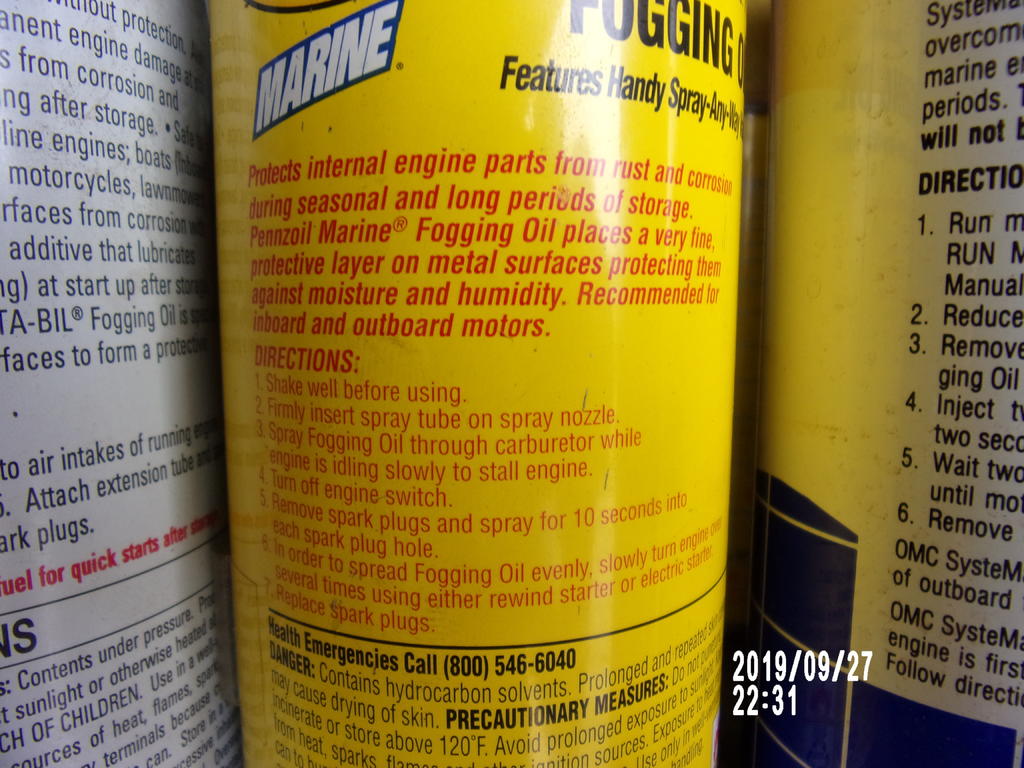

Ed Kennell
102_0615.JPG.fb8a4eb21e744639099492ef9ea32b2c.JPG102_0616.JPG.1573421d1205dd8cb5e9ee7819a41175.JPG
