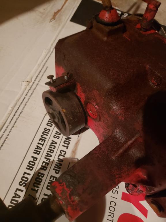

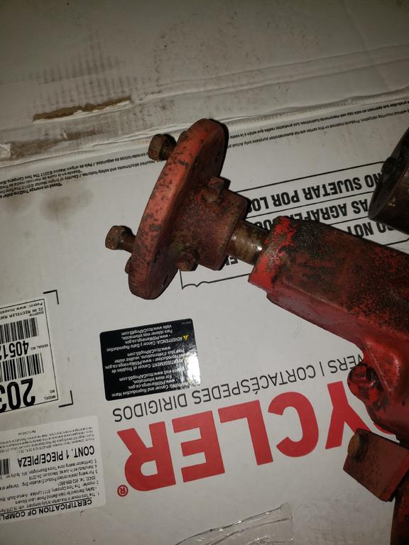

Garry125 4 #6 Posted September 27, 2019 I'm just going to replace the seals. With out tearing it apart. This is the 1 1/8 shaft. What are the part numbers for the seals. I also want to do the brake and pulley seals. How hard are the old seals to remove. Thank you Share this post Link to post Share on other sites
953 nut 64,281 #7 Posted September 27, 2019 The seals are easy to remove (once the hubs have been removed). Just drill a small hole into the metal, run a screw into it and pry the seal out. 1 1/8" is SKF 11050, axles 1" is SKF 9815, brake shaft 3/4" is SKF 7410, input shaft 1 Share this post Link to post Share on other sites

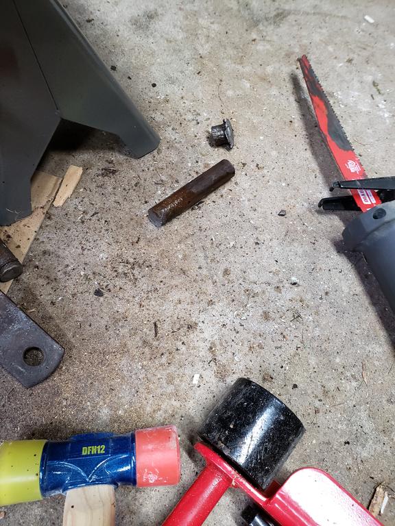

Garry125 4 #17 Posted October 20, 2019 (edited) Finally some good news. Got it out heat and kroil then beat it to the left. Then added oil beat it to the right. Then sawzalled both ends as close as I can to the transmission. Used a socket extension and tapped it through. The spare one I covered with never seize. Went in like butter. Just in time had to put the bagger on for leaves. Edited October 20, 2019 by Garry125 Spelling issues 1 1 Share this post Link to post Share on other sites
