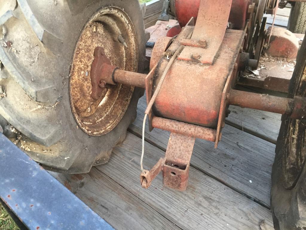

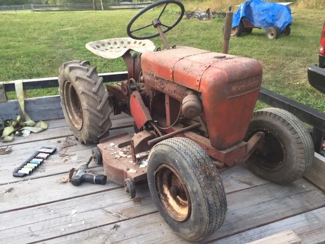

mrshaft696 131 #1 Posted September 23, 2019 So I bought what I think is a 1961 suburban, with a Kohler k91. I bought it at an auction sight unseen, it was stored in a barn for the last few decades at least. It appears to be complete. I would like to do something about the engine before I put any work into any other parts of the tractor because I want to make sure it drives etc. The recoil assembly doesn't work but the engine is free, but feels like low compression or like something is not right. What is a good engine swap for these? I have a 3/4" output for the pulley, so that would be easiest. I have seen predator swaps, but not much info, I would like to find a older briggs possibly, I have a few snow blowers and other small engines around, any suggestions? Also how does that draw bar work? What does the cable connect to? 5 Share this post Link to post Share on other sites
WHNJ701 4,169 #2 Posted September 23, 2019 Nice find, looks like the in ottsville pa. the k91 kohler is great engine and simple to work on. adding a predator type will kill the value of your tractor. it's got great patina get out the red scuff pad and wax it up 1 Share this post Link to post Share on other sites
Mike'sHorseBarn 3,417 #3 Posted September 23, 2019 If I were you, I would take the head off the Kohler and check for a stuck valve. When they sit a long time that is a very common problem and will cause loss of compression. Just soak it in marvel mystery oil for a while and it will come loose. I think fixing the kohler would be more worth the money than an engine swap. Also you can use a Tecumseh style recoil and cup on those 4hp kohlers if you don't want to fix the faribanks-morse recoil that is on it now. I did that with the 401 that I have because it was cheaper to do that than fix the original. Also, that lift cable threads through the tractor and connects to the bottom of your lift arm. 2 Share this post Link to post Share on other sites

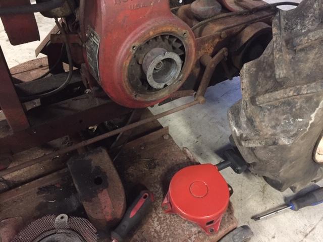

mrshaft696 131 #5 Posted September 23, 2019 2 minutes ago, Mike'sHorseBarn said: If I were you, I would take the head off the Kohler and check for a stuck valve. When they sit a long time that is a very common problem and will cause loss of compression. Just soak it in marvel mystery oil for a while and it will come loose. I think fixing the kohler would be more worth the money than an engine swap. Also you can use a Tecumseh style recoil and cup on those 4hp kohlers if you don't want to fix the faribanks-morse recoil that is on it now. I did that with the 401 that I have because it was cheaper to do that than fix the original. Also, that lift cable threads through the tractor and connects to the bottom of your lift arm. Thanks for the info, yeah I would just like to buy an entire recoil with the cup to mess with the motor... I have a tecumseh recoil from a 5hp snowblower, is that the model you are talking about or would it be from a different engine? Also seems like parts are really hard to find for that kohler, seems like every part listed for it is discontinued. Share this post Link to post Share on other sites
Mike'sHorseBarn 3,417 #6 Posted September 23, 2019 Just now, mrshaft696 said: Thanks for the info, yeah I would just like to buy an entire recoil with the cup to mess with the motor... I have a tecumseh recoil from a 5hp snowblower, is that the model you are talking about or would it be from a different engine? Also seems like parts are really hard to find for that kohler, seems like every part listed for it is discontinued. Try the one off the 5hp and see if it lines up. The one I used was off a 6hp or 7hp though they may be the same thing. You can get most anything you need for the k91 at the website below. His carb kits work in them too. https://isavetractors.com/by-engine-model/kohler-k90-k91/ 1 1 Share this post Link to post Share on other sites
WHNJ701 4,169 #7 Posted September 23, 2019 38 minutes ago, mrshaft696 said: Thanks for the info, yeah I would just like to buy an entire recoil with the cup to mess with the motor... I have a tecumseh recoil from a 5hp snowblower, is that the model you are talking about or would it be from a different engine? Also seems like parts are really hard to find for that kohler, seems like every part listed for it is discontinued. the recoil off a tech tvs 4hp will fit. common on push mowers. you can very easily find all the parts of k91. Share this post Link to post Share on other sites
mrshaft696 131 #8 Posted September 23, 2019 10 minutes ago, jabelman said: the recoil off a tech tvs 4hp will fit. common on push mowers. you can very easily find all the parts of k91. OK I will grab one and see what I got going... The engine will turn one revolution then kind of get stuck a bit and I will have to really pull to get it past, so it could be a valve or something. I need to take the head off and see what things look like. Not sure if I really want a mowing deck on it, but I probably shouldnt sell it. I should have checked isave tractors site, most the places I get parts for newer engines dont list anything really for the old kohler. Share this post Link to post Share on other sites

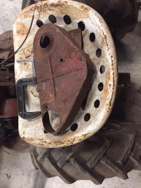

mrshaft696 131 #14 Posted September 24, 2019 13 hours ago, stevasaurus said: Does that K91 have ACR??? The engine could be OK. I am not sure, but there is only a little resistance on the compression stroke and it kind of sticks at that point.... I took a recoil off a 5hp tecumseh engine that I have and it fits on the engine, but I will need a cup that will work. I also got this metal guard with the tractor but I am not sure if it belongs to it or not, look familiar? 2 Share this post Link to post Share on other sites
WHNJ701 4,169 #15 Posted September 24, 2019 that's your belt guard, make sure you save the original recoil too Share this post Link to post Share on other sites
Mike'sHorseBarn 3,417 #16 Posted September 24, 2019 It is pretty rare to find a tractor like that with all the original guards! 1 Share this post Link to post Share on other sites
