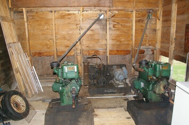

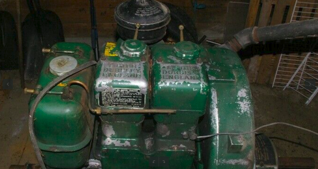

bc.gold 3,406 #30 Posted October 2, 2019 (edited) 18 hours ago, Skipper said: What makes the Diesel a no-brainer for me is the fuel economy This pair of 7 horse power Lister engines went into service 1960 running a refrigeration system for a walk in freezer on a mink ranch that ceased operations in the 80's. Twenty years in service running 24/7 then resting for the last 39 years both engines were fired up a week ago your chances of a gasoline engine firing after sitting at rest for 39 years are next to nil. Points and condensers deteriorate with time wiring insulation breaks down and this often includes the magneto coil and seals stiffen up. Diesel is a light viscosity fuel oil that tends to lubricate parts that is comes into contact with, from my personal experience diesel engines are able to stand for years then quickly brought back to life. I've made an offer on this pair of Lister engines and by the sounds of it I maybe making a road trip. Edited October 2, 2019 by bcgold 1 2 Share this post Link to post Share on other sites
